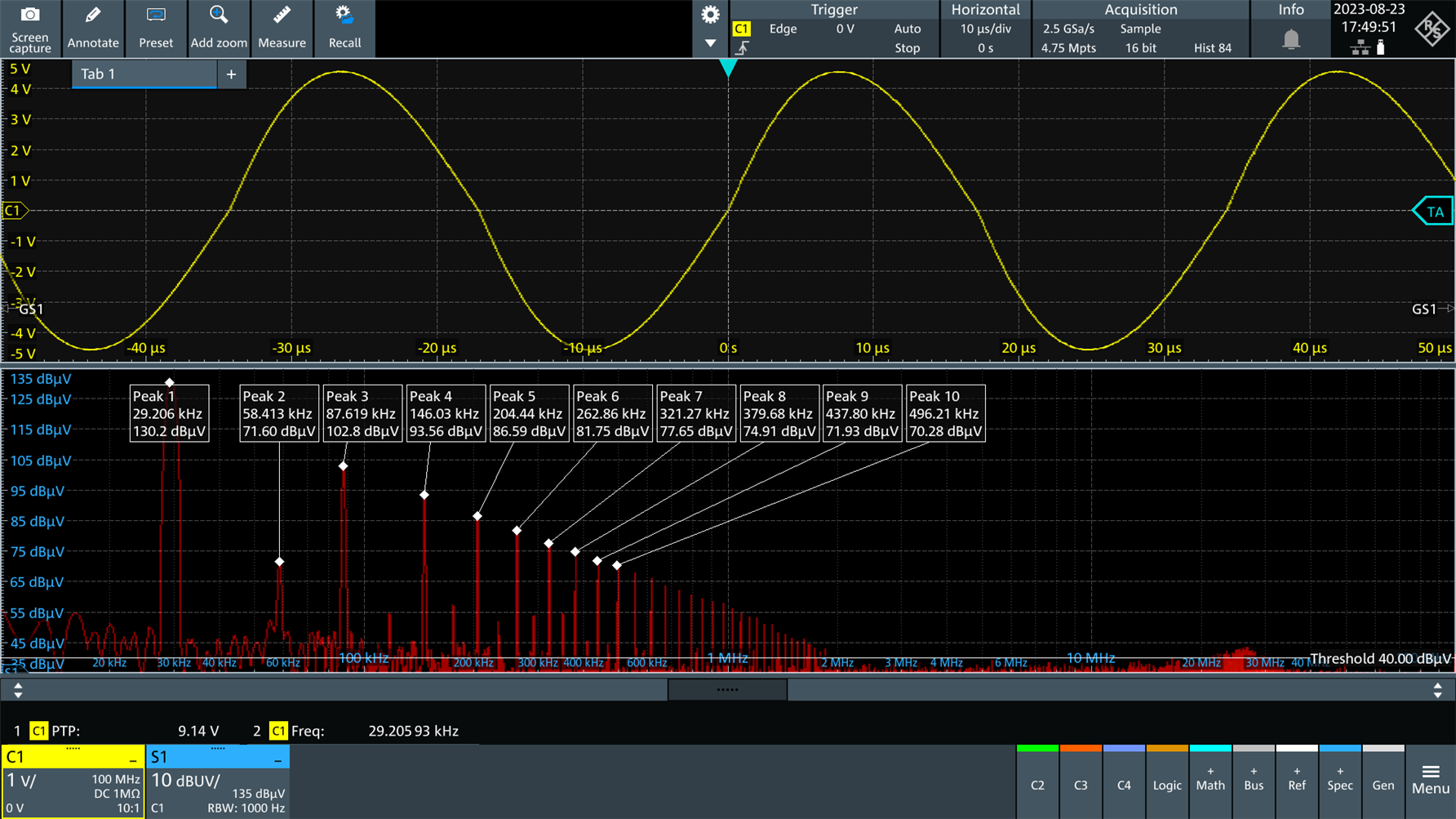

I was experimenting with bits of circuit, hopefully, to become a power supply eventually. It is a work in progress.
At this stage, I’m using bits of scrap copper-clad board, each with a sub-module. It’s too early for a PCB.
However, during the prototyping, I noticed (amongst other issues that I need to solve!) a particular artifact on the ‘scope trace when looking at the output.
This situation ended up being a good example of where it pays to zoom out and look at a lot more of the spectrum view than expected!
Admittedly this was a lot easier to identify using the MXO 4 ‘scope, but it would be possible to spot with other test equipment, such as a spectrum analyzer and a near-field probe. I just used the normal 'scope probe, I didn't do anything special.
With the MXO 4, the anomaly was zoomed in, and then using a logarithmic-frequency spectrum view, it was possible to see the extent of the problem, with the left side of the spectrum view showing the wanted oscillation (fundamental frequency) and its harmonics, and the right side showing the spurious output.
Now I could try to do something about it!
I used tiny ferrite rings (legend has it they were forged by Fair-Rite, part code 2643001501 ) on the base input of the transistors. Essentially, they act as a bit of additional resistance for the higher frequencies. The rings cost $0.02 currently (although more expensive in the UK).
Back to the ‘scope:
Much better!
As mentioned, I still have other problems to deal with, but I thought it was a nice example of why it makes sense to do testing to frequencies far higher than expected, just in case there are spurious emissions, and why it can be a good idea to possess the rings because one never knows when they are needed.

    Here are some results for what I'm calling "Scenario A", which is needing a small negative supply rail for an op-amp, capable of 10 mA or so. For this test, I'm using a 5V power source.
    The ferrite was 5977001101 which is type 77.
    At no load, the input current consumption is 10 mA, and the output looks pretty good (this is probing with a long ground clip, on the AC [i.e. unrectified] output).
    With a schottky diode bridge rectifier, and about 15 uF of output capacitance, I see an output of 4.1V DC.
    It is expected for the waveform to change shape with a load, that is a characteristic of this type of design. The design can be tweaked to try to make the waveform as best as possible at the desired load.
    With a  5 mA load, the output is about 3.2V. With a 10 mA load, the output is just slightly over 3.0V.
    Here is the AC waveform at the input of the bridge rectifier, at 5 mA load:
    Here is the waveform at 10 mA load:
    At the output of the bridge rectifier, at 10 mA load (this is with better probing than with the AC waveforms above):
