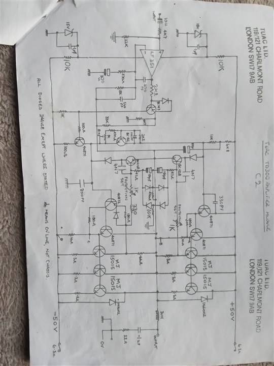

Can someone help identifying what this are? I reckon it is an old diod. Need something to replace it with
kardan
kardan over 2 years ago
imageimageimageTUAC TD500-C1 mono amplifier
TUAC TD500-C1 amplifier boardimage
The simple markings on photo does not have the Anode and Cathode marked.
Please reload the page as I have updated the last image.

    Could be.. I thought maybe the color code was brown-yellow-gray, 148, i.e. maybe 1N4148, but I've not seen that before. Anyway, hopefully photo(s) can make it clearer, or some context.

    For the helpers: Linking in the thread on UK Vintage Radio. There's more relevant info there
    www.vintage-radio.net/.../showthread.php

    These two were missing from the start, my first thought that it might be the same as the other one you marked, but the other one in middle i do not know.
    0 Jan Cumps over 2 years ago in reply to kardan
    If the two holes are connected to the opamp pos and neg supply, I expect it's for a decoupling capacitor
    looking at the photo of the solder side, looks like there wasn't ever something mounted there. The pads look unused.

    One is TD300 the other TD500
  • Ian-Scott
    0 Ian-Scott over 2 years ago in reply to Jan Cumps
    Not unusual on TUAC amp modules for resistors to be omitted or even cut off
