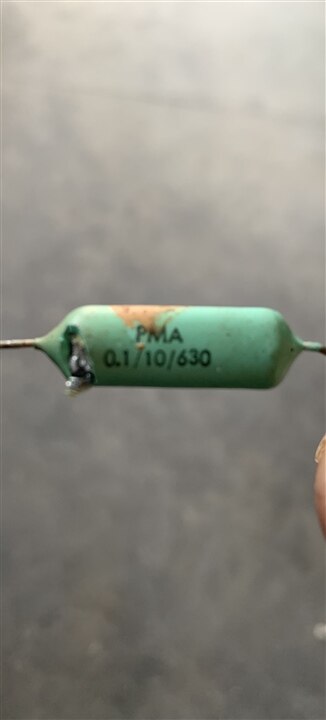

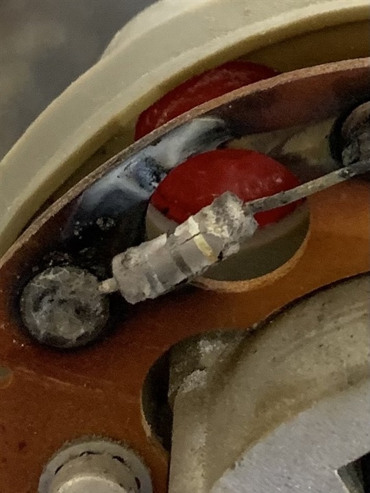

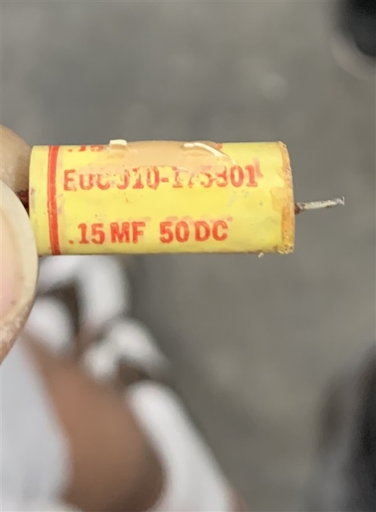

New to the site. I’m no engineer and not an avid electronics enthusiast but I tinker with things. I can research and typically find an answer but I’m having a little difficulty with 2 capacitors and 1 resistor. They’re from an old marine tachometer I’m trying to bring back to life. I’m looking for some help identifying them and suitable replacements. I have attached a couple of pictures.
Any help is very much appreciated.

    For Picture 1, you'd be better off searching for a schematic for that tach.  It's fried beyond recognition for me.
    Picture 2:  https://www.newark.com/cornell-dubilier/942c20p15k-f/film-capacitor-pp-0-15uf-2000v/dp/66K5447
    Picture 3: https://www.newark.com/cornell-dubilier/940c20p1k-f/capacitor-polypropylene-pp-film/dp/66K5379

    Kmikemoo, I’m trying to reply on my phone so not sure how to tag you but, thank you! Yeah, that resistor is toasted, I can identify the last 3 bands but not the first. I’ve been scouring the www for a schematic but nothing comes up for the darn thing. If I had found oIt’s a 70’s omc accessories 2 wire tach, just signal input and ground. It was made by gale products and model # is 121614. If I do find one it will be a lot easier.
