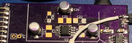

    In the electronic load we've designed here on element14, there are 3 polymer caps from Panasonic: 16SVPG47M16SVPG47M
    Conductive Polymer Aluminum Solid Capacitors, 16 V, 47 µ
    On the PCB, there's an alternative footprint for different style of capacitors, to allow experimenting (for MuRaTa -out of stock - ceramic type GRM32ER61C476KE15LGRM32ER61C476KE15L).
