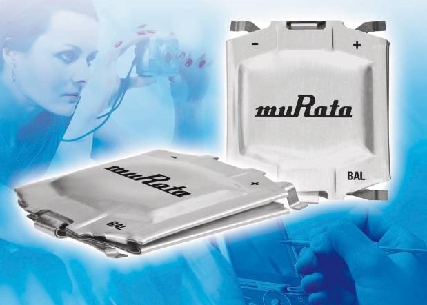

Murata, in partnership with Cap-XX, has also announced its first range of super-capacitor products (Supercaps), the DMC series using EDLC (electric double layer capacitor) technology.
This series is ideally suited for mobile applications requiring burst power or peak power assists unable to be handled by Li-ion batteries, enabling innovative, smaller, lighter devices with increased functionality and longer battery life.
The DMC series of Supercaps features low ESR and high capacitance in small and thin packages. Parts with peak rated voltage of 5.5V in package size 20.5 x 18.5 x 3.2mm (max) exhibit capacitance between 250 and 450mF +/-20% and ESR from 100 down to 60mOhm +/-10%.
Single Cell types with peak rated voltage of 2.7V feature package size of 20.5 x 18.5 x 1.6mm (max) and exhibit capacitance between 400 and 900mF +/-20% and ESR from 50 down to 30mOhm +/-10%.
More info coming soon.
