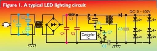

A typical LED lighting circuit is shown in figure 1. For C1, C2, and C3 safety recognised capacitors should be selected that are rated AC250Vrms. C6 is the snubber capacitor for the diode; parts rated to withstand DC 250V to DC 630V are needed and these can have X7R temperature characteristic. For C7, the snubber capacitor of the FET, a higher voltage rating of DC 630V to DC 1kV is necessary, and Murata recommends type U2J temperature compensated capacitors. C8 is the smoothing capacitor for the secondary circuit for which any part rated to 100V should be sufficient.

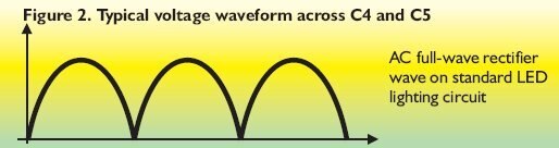

The capacitors in the circuit subject to the harshest conditions are C4 and C5, which act as AC smoothing or noise filter capacitors for the primary circuit. The typical working voltage on these capacitors is the full-wave rectified waveform shown in figure 2. X7R capacitors that are rated to DC 250V are often (wrongly) chosen for C4 and C5. The problem is that when high dielectric constant capacitors like these are subjected to full-wave rectified voltages, they succumb to the electrostrictive effect, which can cause fatal cracks in the dielectric material.

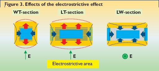

The electrostrictive effect applies to all dielectric materials. When an AC voltage is applied, the capacitor effectively stretches and shrinks in the different dimensions, as shown in figure 3. Mechanical distortion and stress concentrate around the edge of the external electrode of the capacitor. If the AC voltage is large, and the material has sufficient dielectric properties, after some time cracks can form under the external electrode which can lead to catastrophic short circuit failure of the component.

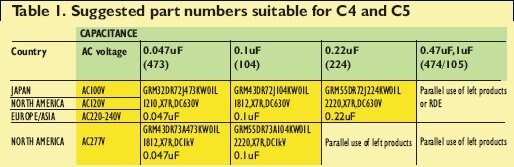

Taking all these factors into account, Murata recommends parts from its GRM series of multilayer ceramic capacitors for C4 and C5 that are able to exceed the minimum lifetime required whilst subjected to the operating conditions described above (see table 1 for suggested part numbers). These parts have the X7R
temperature characteristic and come in a range of values; DC 630V rated parts come with capacitance between 0.001 and 0.22μF and DC 1kV rated parts range from 0.00047 to 0.1μF.
