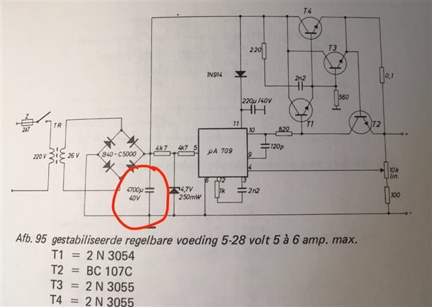

    gpolder over 7 years ago in reply to rscasny
    Hi Randall,
    I just did a parametric search on https://industrial.panasonic.com/ on POSCAP and SP-CAP capacitors.
    Unfortunately there is no component coming close to the capacity or voltage of what was used in this vintage linear power supply:
