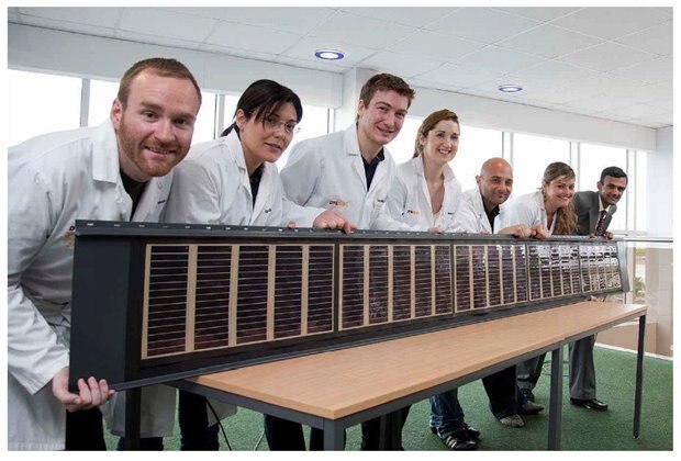

Rooftops globally are millions of acres of under tapped surface area prime for solar conversion. The structures are, in most cases, connected to the grid's of their respective countries, so energy distribution is built in. Many large companies are making the installation a standard for their sunniest stores. A certain new partnership seeks to make long roofing panels with integrated solar elements an option to traditional materials.
One of the world's top 10 steel manufacturers Tata Steel Corporation has partnered with a leading supplier of 3rd generation solar technology, Dyesol, in creating the world's largest dye-sensitized solar cell (DSSC)thin-film panel. The module measures over 3 meters in length and is 1 square meter in overall photovoltaic surface area. The innovative manufacturing process allows the Tata/Dyesol collaboration to print the solar cells directly to the steel. This allows for the manufacture of large volumes of cost effective cells to be made to exactly fit the shape of the structure. Tata Steel Operations Manager states that they have already "successfully produced hundreds of meters of printed steel and polymer film" used in the prototypes.
Dye-sensitized cell construction is printed in the following layers. The top layer, anode, is made of tin dioxide (SnO2:F) deposited on the back of glass. Below this is a layer of iodide electrolyte, sometime platinum, and is sealed with the next layer to prevent leaking. The next, and final, is a conducting layer of titanium dioxide (TiO2), dipped in a photosensitive dye, ruthenium-polypyridine.
The possibility for an electron to re-enter the dye after absorption is quite slow compared to the transfer from the platinum layer to the electrolyte. This differential is favorable allowing the cell to work in low light and cloudy day conditions. Even though DSSC panels have a 5%-12% efficiency rating the ability to charge for longer periods of time may make the cells more productive than their silicon counterparts (silicon cells rate at 12%-15%).
Tata/Dyesol finished the 3 year joint project in this June, 2011. 20 more people are needed for the team while they prepare for the pre-industrialization phase of the project. Like not recycling, the ease of the Tata/Dyesol panels make it almost a crime not to use rooftop solar collection. Great job Tata and Dyesol.

Picture via Tata/Dysol
