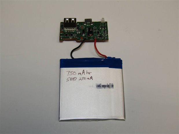

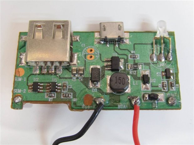

    jw0752 over 5 years ago +4
    Hi Again OT, Here is a picture of one that I took apart to use in a similar fashion to what you describe. John
    If you have an old auxiliary backup battery for a cell phone there is a circuit inside that takes the 3.7 volts of the battery and boosts it to 5 volts. This circuit will also allow you to charge the 3.7 Lithium battery with a standard phone charger. The only catch is that it may require a certain level of output current to remain on. In other words the 5 V device that you want to power with the battery might have to draw 20 or more mA to keep the circuit engaged.
