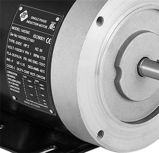

    To "swap" a motor, you need to look at the following characteristics: 1) Voltage and phase (single or 3) - 120VAC 2) Current draw / wire size - 15A 3) Frame size / HP rating 4) Mounting locations 5) Shaft…
  • rsc
    rsc over 5 years ago
    5) Shaft size - diameter and length to coupling, key or ??
    6) Shaft coupling type and size
    7) Duty cycle and Rotation direction
    Post a picture like shown below of the motor ID tag and mounting for more help
