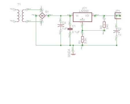

    bheemarao over 15 years ago
    Hi,image
    i had done the below circuit and tested, it is working fine but the maximum current deliver in only 200mA max, can any one suggest me the solution for driving 1A.
    Best Rgds
    Bheema
  • WarrenW
    WarrenW over 15 years ago in reply to bheemarao
    Looking at the design, it seems this is most likely drive from main voltages and therefore quite likely to be a 50 or 60 Hz supply. In this case the capacitor you have choosen as you filter (1uF C3) is way too small. Try increasing it to 1000uF. As a general rule of thumb I use 1000uF per Amper per volt drop as a guidline. e.g 1000uF filter @ 1 A load should equate to approx 1 volts drop in the supply volts to the regulator. You have shown a 1uF filter capacitor (C3) so virtually no regulation exists before the LM350 and I would expect in those circumstances to see quite an AC component on your 'regulated' DC output.
    Cheers
    Warren.
  • bheemarao
    bheemarao over 15 years ago in reply to WarrenW
    Thanks Warren,
    I will try changing C3 to 1000uf.
    Best Rdgs
    Bheema
  • enrico.migchels
    enrico.migchels over 15 years ago in reply to bheemarao
    Hi Bheema,
    Surprising to see that your power supply design is a linear device; transformer and linear regulator. This is really old techology and will make your system perform poor. There is only benefit with your design. It is simple to design, but that should be no argument anymore these days. There are plenty off the shelve products and designs efficient switching power supplies.
    Best regards, Enrico Migchels
