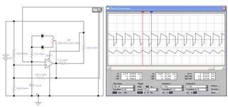

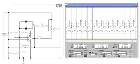

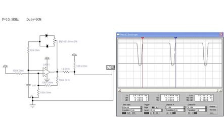

I have a problem when I am debuging. My PWM generate circuit can not adjust the duty cycle to 10%! It just 46% when I modulate Rp_Potentiometer.SCH.jpg
But I have checked the circuit by a software called EWB and the follow images are test result.
1 R_potentiometer =100k Ohm  100%
   Duty cycle=10%

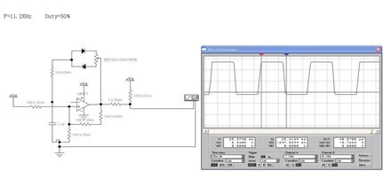

2 R_potentiometer =100k Ohm   50%
   Duty cycle=50%
3 R_potentiometer =100k Ohm      0%
   Duty cycle=90%
Why? Can anyone tell me why!

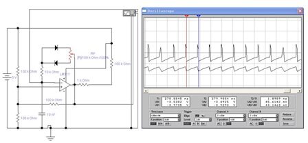

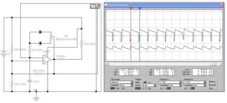

  • Jason
    Jason over 15 years ago in reply to albertosombri
    Hi, Alberto

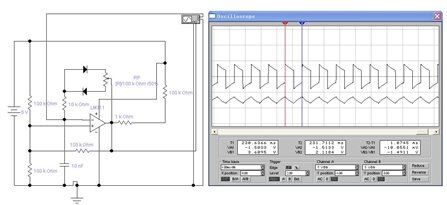

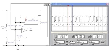

    My AMP is LM311 Fairchild, and resistor connected to the anti-parallel diods is 10k Ohm--R7, the Potentiometer RP=0~100K Ohm.
    I try to change the value of R7, it only cause the change of output frequency, the duty cycle can not adjust to 10%.
    The following images is the photo of capacitor waveform.
    1,RP_Potentiometer=0%  Duty=90%
    2,RP_Potentiometer=25%  Duty=70%
    3,RP_Potentiometer=50%  Duty=51%
    4,RP_Potentiometer=75%  Duty=30%
    5,RP_Potentiometer=100%  Duty=9%

  • michaelkellett
    michaelkellett over 15 years ago
    Hello,
    I have already answered you on this one in the Analogue group where you also asked.

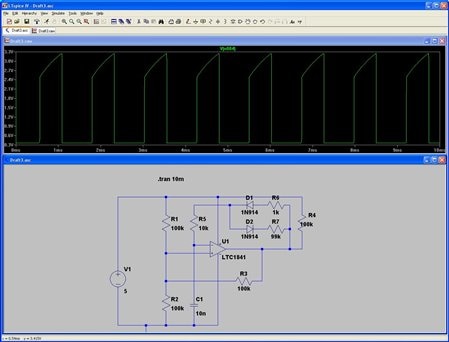

    The LM311 is NOT an op amp - it's a comparator with an OPEN COLLECTOR output.
    It can only sink current not source it. You need a pull up resistor to 5V (I'm assuming that is the value of your Vcc). The resistor should be a low value compared with the load ie which is 10k in your case so the pull up should be 1k.
    If EWB does not correctly simulate the LM311 I suggest you use a simulator that works in future (try LTspice which is a free download at www.linear.com).

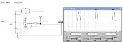

  • michaelkellett
    michaelkellett over 15 years ago in reply to albertosombri
    Alberto - you are not quite right about open collector outputs. They can only sink current and not source it. If you refer to the last diagram in Jason's post you see he has resistors of 100k and 1k in series to the 5V supply. When the pot is set to the lower extreme the output of the comparator is trying to charge the capacitor though a 10k resistor - but the only path for current into the capacitor is though the 100k, the 1k and the 10k resistor - that's why the ciruit doesn't work properly. All that is needed is 1k from the output of the comp. to the 5V supply and he will get his 10/90 (approximately) range in duty cycle
    Reducing the feedback fixed resistor to 1k won't help at all.

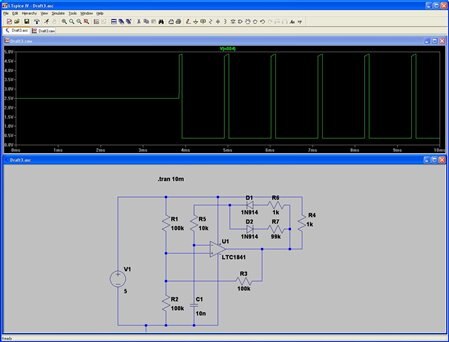

  • michaelkellett
    Hello Alberto,
    We can improve your formula to show the effect of the open collector output with 101k pull up:
    T = C * R (during the charge) + C * R (during the discharge) - your formula
    actually there is an additional constant:
    T = K(C * R (during the charge) + C * R (during the discharge)) - K is determined by the values of the bias and feedback on the positive input. Actually even this is not totally accurate because the diodes have an effect but we wont go into that here.
    If we now put in the effect of the OC stage:
         T=  K(C * (Rpot(x)+R7+101k)) + (C * (Rpot(1-x)+R7))
    and the charge period range is:
              K(C* 111k) to K(C*211k)
    the discharge period is:
         K(C* 100k) to K(C*10k)
    so the PW range is 111/(111+100) to 211/(211+10) = 52.6% to 95.5%
    I can't make any sense out of the EWB simulation.

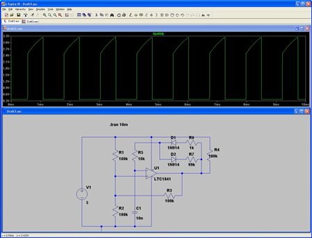

    I've simulated it with LTSpice and used an LTC1841 comaprator (still has open collector style output).
    First with 100k pull up and second with 1k pull up.
    In case the pictures are illegible (they look too small as I'm doing this) I have  attached the jpeg files.
