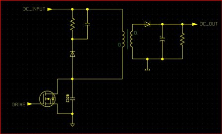

    Hi Alexandru,
    This a standard subber implement in a flyback converter. It is a nice one to start with. The RCD-snubber limits the voltage on the drain-source caused by the leakage inductance of the coupled inductor. The capacitor across the mosfet helps also for this but this capacitor also limits the dv/dt on the mosfet to avoid component problems and high EMI levels.
    If you need help let me know.

    Hi,
    Thank you both for your help. It has been very usefull. I have tried these simple circuits and it's ok. Can you now suggest me a more complex simulation?
    Controlling a TRIAC or IGBT.
    I appreciate your help! Thanks.
  • enrico.migchels
    enrico.migchels over 15 years ago in reply to Former Member
    Hi there,
    Can you share the results of the simulation? Plots and circuit parameters?
    Triacs have RC-circuits across A1-A2 to limit dv/dt (fast dv/dt will turn-on the device without gate triggering). Sometimes there is a coil in series with the traic to limit di/dt (fast di/dt can destroy the device). There are special triac, called 4 quadrant traic's which don't need the dv/dt snubber but they require a certain gate-fire pulse. I used them in a project and they performed very nice.
    Best regards, Enrico Migchels
