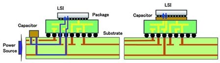

Fujitsu Laboratories announced the development of a process technology to produce capacitors for high-speed LSI chips, which, as a world's first, employs copper for internal electrodes. The use of copper for internal electrodes lowers the impedance of the capacitor itself, and by mounting the capacitor directly below the LSI chip, impedance from the circuits can also be reduced, resulting in increase of current-flow efficiency by 10 times compared to previously available technology. The new technology is expected to enable the next generation of high-speed computers to operate at even higher speeds. As LSI chips continue to achieve higher speeds and higher integration densities, and with many of a chip's elements all operating simultaneously, much of the current used by the chip is consumed in bursts. This can lower voltages, which may impact proper operation. In those instances in which much current is consumed, it is desirable to mount a capacitor near the LSI chip to instantly supplement the current. Conventionally, ceramic-chip condensers being used as power-supply capacitors have been mounted on the surface or rear of the circuit board or LSI chip package, supplying current to the LSI chip through the circuit wires. This method results in a relatively long electrical pathway between the capacitor and LSI chip, which raises impedance and would potentially create instabilities in future high-speed PC’s. In addition, because nickel, which has comparatively high resistance, has conventionally been used for the internal electrodes in the capacitor, the impedance of the capacitor itself has been high, limiting the speed of the power-supply current. Fujitsu Laboratories developed a basic manufacturing method for capacitors that can provide high-speed, stable supply of current to an LSI chip. Employing copper for the internal electrodes to lower the impedance of the capacitor itself reduces the length of the circuits between the capacitor and the LSI chip, making it is possible to limit impedance of the power-supply line. These factors together result in a power supply that is 10 times as efficient for operationally stable high-speed LSI chips, a development that is expected to contribute to higher computer speeds.
