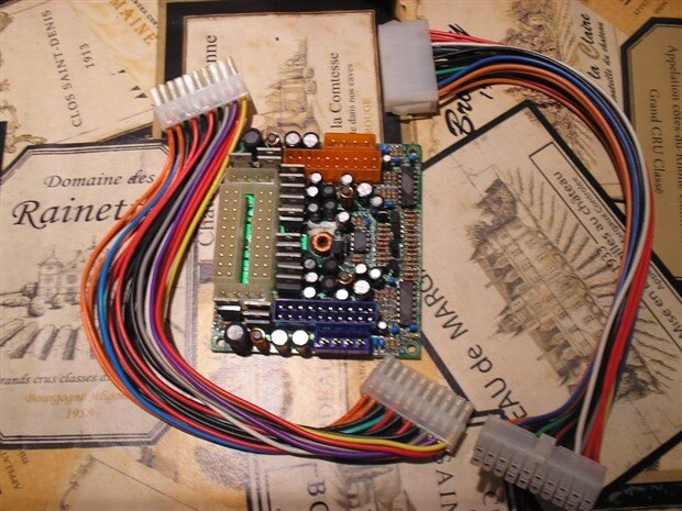

HI
I am thinking of taking 4 Servers I have basic Motherboards I have and puttting them in one case.
I Am wondering if there is a power supply out there that would do multiple Motherboards but I also want to have it so I have a second power supply that is redundant.  I believe this should be possible
Any clue IF this is possible or not
  • Workshopshed
    0 Workshopshed over 11 years ago
    Brandon, I was asking myself the same question many years back and found these boards. They take in a single ATX style power connector and split it into two. The purpose of all the components is to switch the power on and off in the same way a usual ATX power supply. The boards were more expensive than a regular PSU but I was very tight on space at the time. I am not aware of a supplier who still makes these.
    A bit of googling found this mention:
    http://www.tomshardware.co.uk/phanteks-atx-enthoo-evole-pro-m-cases,news-50430.html
    0 balearicdynamics over 11 years ago
    Hello Brandon,
    let me ask a question: how do this multiple motherboard server connects together the four systems? You will drive in some way as a quad-server and a single OS controlling all or a multiple series of different units (with their boot, OS etc.) connected through LAN like making a cloud ?
