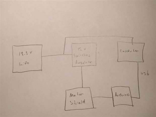

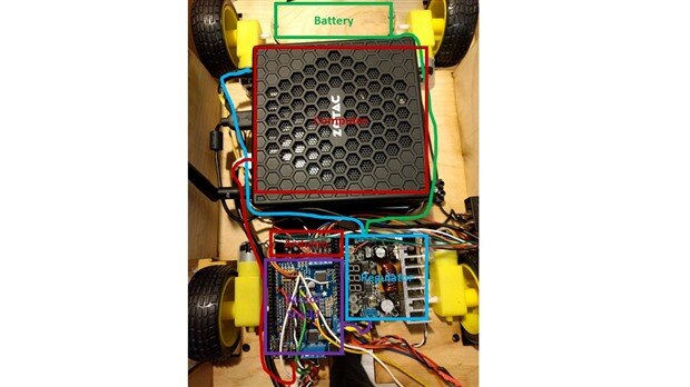

Hello,
     For this year's science fair project I am creating an object collection robot. It uses a webcam and a small windows PC to perform computer vision operations while an Arduino Mega and an Adafruit motor shield (found here: https://learn.adafruit.com/adafruit-motor-shield-v2-for-arduino/overview) interfaces the hardware. As you can see from the attached image, the computer and regulator (found here: http://www.amazon.com/dp/B015YZZ1G8/ref=sr_ph?ie=UTF8&qid=1450756203&sr=1&keywords=voltage+regulator) for the motor shield's power are in parallel with each other, both of which are being powered by an 18.5 volt LIPO battery. The Arduino is being powered separately from the PC's USB port. I imagined that this would all work very well, except when the computer is on at the sane time the motors are being powered, the computer immediately shuts down and the Arduino loses power. After a few seconds it will attempt to restart, the arduino will be powered on, commanding the motor shield to draw power from the regulator and the cycle will repeat. Initially I thought the battery was not able to provide sufficient power, however after using substituting in a power supply the same thing happened (and in any case this does not draw more than 1 amp at any time, a current the battery is more than capable of supplying). My next thought was that the voltage regulator is introducing unwanted noise into the mix, (and so much so that the computer is unable to run properly) as everything works as intended if the regulator is removed from the circuit and powered separately. Unfortunately, I do not have an oscilloscope to test for such a thing and I do not know enough about this sort of thing to know what sort of filtering to use, and so it is here I turn to the community for help. Is it a noise issue or something else, and what can I do about it?

    I hate to say this but by far your best bet is to borrow a scope. You need to look at those power rails and see what is actually happening. Anyone reading you post will be just guessing (they may make quite good guesses but it's a bad way of working and certainly not engineering).
    The issue will (probably)  be either the power rail dipping or some kind of spikes generated by the motor control getting into the PC and resetting it. Very hard to tell which without some measuring.
    Try asking around locally - I know if I were asked I'd help out with a local request for aid I would oblige, and I'm sure people near you will do so.

    Your initial assumption may still be the most likely culprit except there is a combination of things conspiring to make the voltage sag.
    I'm not sure which Zotac you are running, but it looks like they take between 8 and 30 Watts depending on the model and what is running, so possibly taking over an amp. The stepper could also be taking a bit more than expected since both windings may be powered at the same time - even when not moving. The arduino also takes some current of course.
    I can't tell what gauge of wire you are using from the battery, but make sure it is heavy enough not to cause a significant voltage drop. Any connectors in the circuit can also introduce resistance and voltage drops. Try measuring the voltage directly on the battery and at the PC and right on the motor controller to see if there is a drop in voltage across the wire. You could also try substituting a load for each device to see if the voltage stays up with a known load. You might try measuring current to see exactly what it is, and if it is excessive.
