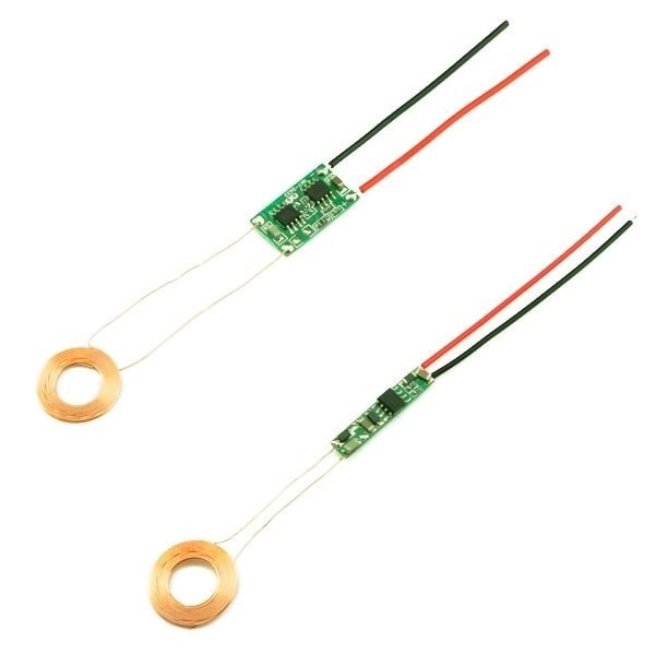

    0 balearicdynamics over 10 years ago in reply to jonivanart
    Hi Jon,
    thank you for the warning. This is something I almost know but unfortunately I am not a big expert (nor a small image ) in the calculation of the battery systems. I'll try to be more specific.
    The battery is the following in the image below, with the listed characteristics:
    LiPo rechargeable battery, 500mA/h, 3.7 V, 48x20x4 mm dimensions
    I plan to use a coil inductance recharger like the one shown in the image below:
    Generating an output regulated voltage of 3.7 or 5V with 100-300 mA power and - as far as I know (declared by the producer) it should charge single-cells LiPo batteries.
    Enrico

    0 balearicdynamics over 10 years ago in reply to amgalbu
    Hi Ambrogio!
    Thank you for your suggestion. That's what I was supposing. So with a lower power supply charger for me it is not matter if the charge time is a bit longer.
    BTW, the wireless charging seems not possible due the dimensions of the coil that will require a too large size of the device box.
