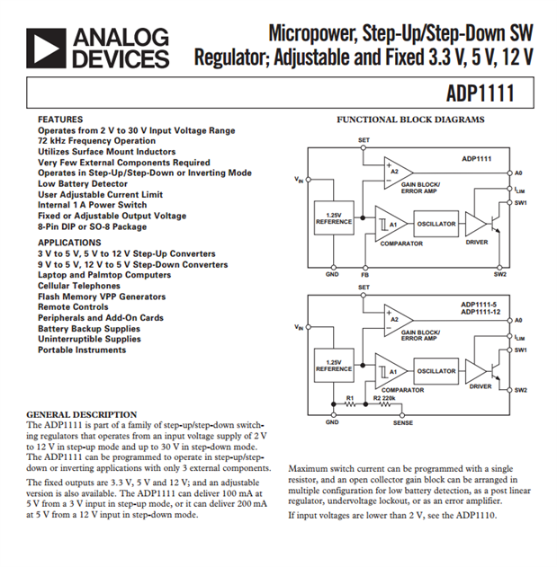

    0 jw0752 over 10 years ago
    Hi Nico,
    For your regulator you might consider one of these Buck - Boost DC/DC switching Regulators. They are much more efficient than the linear regulators. Also I do not believe you have enough room between your 3.6V batter and 3.3V application to fit even an LDO linear regulator. I tried to tie a link from Newark but the site was down a few minutes ago so here is a partial Data Sheet. The supply can be from 2 Volts to 30 volts and the output locks onto 3.3 volts if that is the fixed output you have chosen. When Newark is up again you can search their stock and download the entire data sheet.
