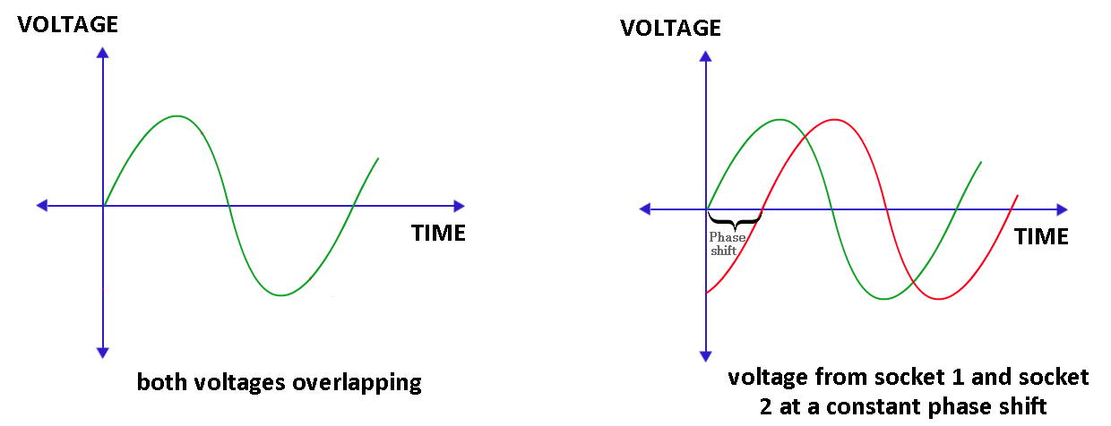

Most countries use AC power that is supplied to each house. This AC power is in the form of a sine wave. My question is that suppose I have 2 electrical power sockets in two rooms that are at the opposite ends of my house. Will both the electrical sockets provide the same sine wave that is in phase or will the electrical power be at a constant phase shift. What will it be like out of the two ghaphs:-

    Hi Rishi,
    I do not know about your location but here in the USA the power is brought into residential homes as 2 phase off a central ground or Neutral. If power is taken from the Neutral to either phase the result is 115 Volts 60 Hz. If a tap is taken between the two phases ( 180 Degrees ) the resultant voltage is 230 Volts 60 Hz. When the house is wired there is an attempt to put equal load on the two 115 Volt phases and all the larger appliances, Stove, Dryer, Water Heater and Air conditioning are placed on the 230 Volt differential between the two phases. As a result of this arrangement it is possible to measure 230 Volts from the hot wire of one 115 Volt wall outlet to the hot wire of a second adjacent outlet, though a good electrician will seek to avoid this situation.
