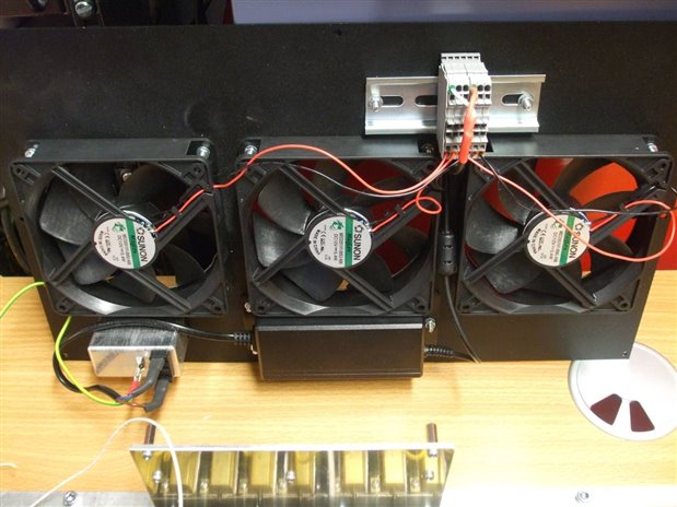

    I'm happy that your supply was working OK but that "Indestructible" has some really awful design and construction practice - you shouldn't just plonk one earth wire on top of another while adding to the solder blob and gently caressing it with the iron (he's doing that so as to not melt the whole blob and have the first wires fall off). It's bad because the interface between the different layers of partially melted solder won't be reliable. The joint should be mechanically stable before you simultaneously apply the iron and the solder. Also, and especially for home built or prototypes, you should protect the mains wiring with heatshrink sleeving, or in some other way, so that when you are poking about inside trying to get it to work you don't accidentally touch the mains. I use complete mains inlet, filter, switch devices which avoid the need for so much mains wiring - they cost a bit more but are much safer and better.
    The picture shows how I get 12V at 5A into a box:
    I've said this before, but it may save others from problems, any supply based on the LTC3780 will be noisy, it can be very efficient but it's really hard to get rid of the noise spikes which may affect other circuits.
