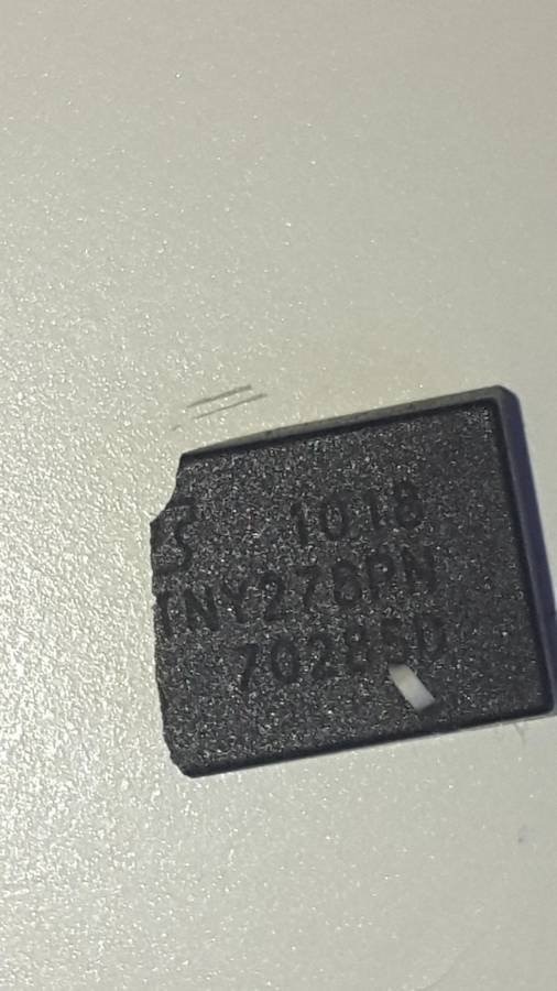

I changed the fuse and tried again. Nothing. I disassembled my power source, shorted all capacitors to make sure I don't fry my fingers and while doing so, I saw a black piece of silicone falling of. Little did I know it was from an AC/DC Off-line switch.
After visual analysis it was clear, the switch blew and left smoke on the nearby components.
I took of the switch today and I am expecting a new one from farnell in a few days.

    Here is the switch 7 contact points of which I could've find just 6 because the way it has blown off The switch in cause is  TNY278PNTNY278PN with THIS datasheet.
    Unfortunately, the datasheet does not have a lot of meaning for me.

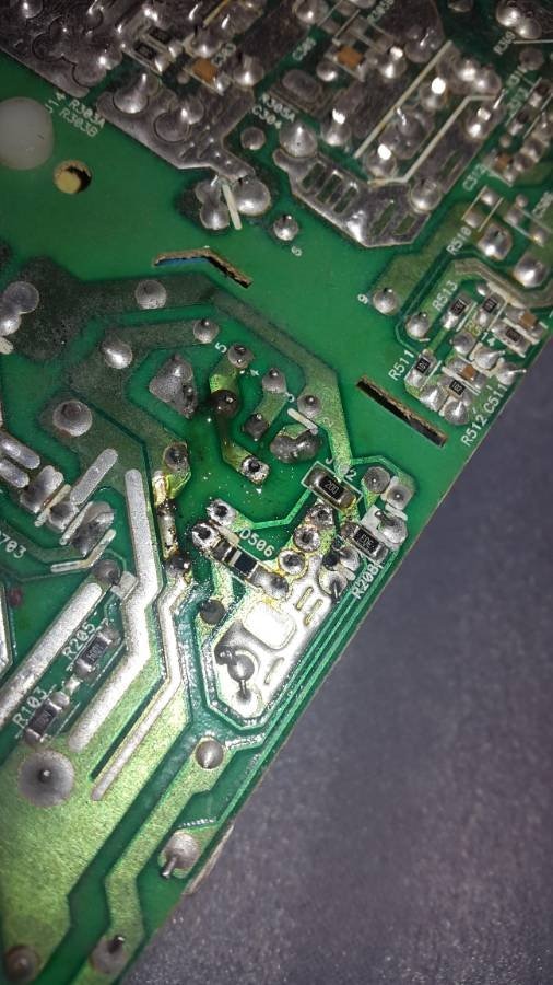

    And photo of my PSU pcb:
    \image
    So you can see that "D506" writing, that is exactly the place where 4+3 Pins would have been before from this switch. I know the pcb looks messy, but I cleaned it with isopropyl. That mess is from the flux.

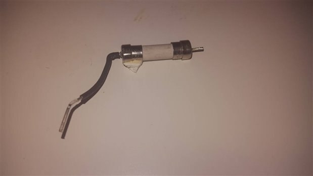

    More, I tried to spot the fuses on the pcb (and found only 1, which is blown):
    So far we have this fuse which is blown inside the PSU and another fuse which is blown in the cable's head (which goes to socket). I've already ordered other fuses for sockets to replace these (from user suggestions).
    This last one which I discovered has a writing on it saying: "T10AH 250V" and the company logo.

    We had a real failure to communicate. When you said switch I thought you meant a physical switch and not a solid state switching IC. Now that I have seen your picture and your explanation I will say that there is a real possibility that the damage that you see was caused by an unseen failure somewhere in the circuit. Before the IC is replaced it would be prudent to test all the support components as well as checking the output of the circuit to make sure that there isn't a short on the output rails. Switching Power Supplies can be particularly difficult to service as they have feed back loops that can affect the circuits performance. Sorry that this happened and sorry I may have lead you astray with my previous explanations.

    I don't know but your computer itself is probably ok. Most power supplies are protected from external shorts or over current loads and a problem in the computer should not have caused this failure. It is possible that an unseen problem in the power supply caused this and that is why it would be a good idea to test support components in the power supply. For example the small black diodes with a silver band on one end could easily have been damaged by the 10 amp short that took out the fuse but externally they might not show any damage. They can be checked with a multimeter set on R X 1 Ohms. Switch the leads back and forth on the component and expect a reading in one direction and no reading in the other.  Since you have the IC coming if everything else checks out you can try replacing it. The worst case will be more blown fuses and another fried chip. Be cautious with the power supply as this type of power supply does have lethal mains voltage on it when plugged in.

    I love that you always respond really fast. I have been notified by email about your reply and tested immediately. I have tested the diodes. 4 of them are dead (checked both poles) other than that, I've discovered a popped capacitor (not the very big one, but a smaller one).
    Because this problem goes further and further with damaged components, I will just remove all the components from it and keep them for scrap. I can see that there is no point to repair this PSU. I strongly hope there is no damage on the motherboard.
