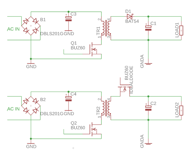

Hello all,
Requesting some expert advice for some exploritative reseach I am currently undertaking...
A typical DCDC flyback converter uses a diode on the output of the secondary, then pumps into a capacitor before going off to the load.  Very common in USB power supplies from poundland etc etc.  Typically this diode gets rather toasty, particularly on USB supplies rated at 2.4A or higher.
I've used dual ideal diodes in the past and am interested in whether we could replace this hot diode with an ideal diode.  Assuming I can get a stable supply to the controller would the switching time of an ideal diode be fast enough (gut feeling is yes).
Can anyone spot any glaring issues with this concept? Except cost of course!
Many thanks
Simon
Example schematic, quick sketch omitting the controllers:

    I've got a big SMPS here that uses mosfets as output regulation diodes, it's resonant converter of some sort.
    Plenty of documents online on resonant power supply that use "synchronous rectifier" which is just another term for your "ideal diode"
    Here are the specs for the mosfet used.
    BSC016N04LS mosfets are being used to supply 12V 50A
    Vds 40V Rds 1.6mOhm Id 100A
    these mosfets are SMD devices and have no heatsinks attached.
