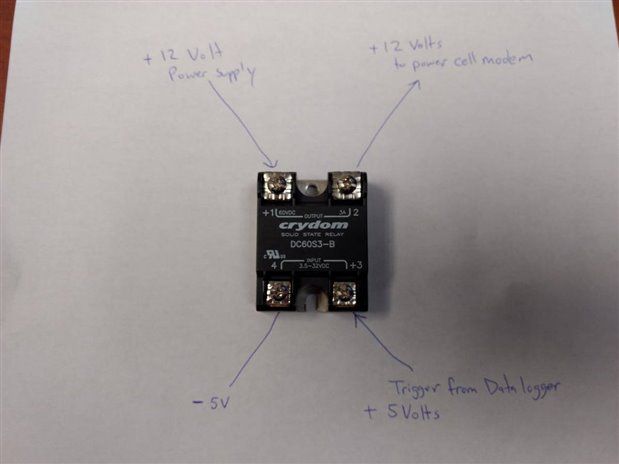

Hello,   I purchased a SS relay Crydom DC60S3-B .   I intended to use it to power a cell modem (12 volt) and need it to be normally closed, so the modem always has power.    To save power, a program controlled data logger would apply 5 volts to the relay control when the modem wasn't needed to be on.  This configuration allows me to connect to the data logger through the modem, and if changes are made to the data logger program, power is Normally applied to the modem and the connection is not lost.    The problem is that the relay doesn't seem to ever be in a open condition.     My data logger program applies 5 volts to the relay input, but power output (12 V) is still going out across the relay.  The actual voltage does drop(dropped 12.8 to 12.6 volts), but does not turn off.      Is this the wrong relay for this application?

    jwmartin Your drawing above shows a -5v on Pin4 and then +5v from the Datalogger on Pin3. You should have Pin4 connected to ground or zero volts. (the same 5v supply you're using to provide the 5v from…

    Hi Joe, Is the coil voltage specified at ~5v ? Any possibility you can provide a few photos or a circuit diagram to help the E14 community work out what is wrong. regards, Rod

    The relay input is 3.5-32 VDC. The output rating is 60 VDC 3Amps.

    The relay input is 3.5-32 VDC.  The output rating is 60 VDC 3Amps.   image

    I've never used one of these solid state relays before but it looks to me like you've wired it correctly (e.g. against the datasheet here ).image
    I notice the datasheet mentions a minimum load current of 20mA - so if you don't have an actual load perhaps that is an issue? Add a 560R resistor to ground would meet that at 12v.
    The only other thing I noticed was that the specification has a flyback diode to protect the output.
    regards,
    Rod
    You should have Pin4 connected to ground or zero volts. (the same 5v supply you're using to provide the 5v from the datalogger)
    This means that wehn your datalogger triggers, there will be 5v across the control (Pin 3 and Pin4) side of the SSR.
    A quick check is to put a LED with series resistor across Pin3 and Pin4 and you should see it light when you trigger it, and go out when it's off.
