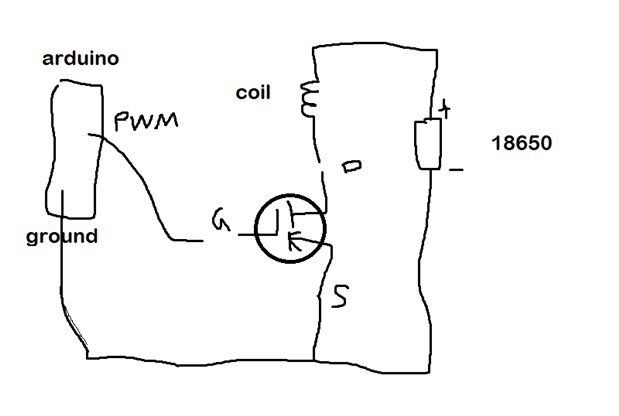

I was wondering, if I wire for example 2 2700ma batteries in series to get roughly  8.4 v cell fully charged but use a step down convertor to bring the voltage down to 5v do I gain back any of the capacity between the two cells? Ideally I would want to wire in parallel for the project but unfortunately I need to draw up to 3.7ish V which would become impossible as the batteries discharge. I'm new here so please go easy on me I'm trying to do as much reading as I can but would appreciate the help.

    Thanks for the reply Fabio, my project uses a Mosfet to control the resulting voltage I'm just a bit confused as to where all the extra voltage is going. if the resistance of the coil I'm using remains constant and the voltage I'm effectively supplying is around 3-3.7v am I conserving power at all. sorry I'm very new to electronics programming is more my deal.

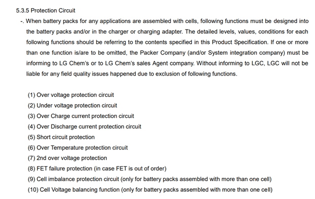

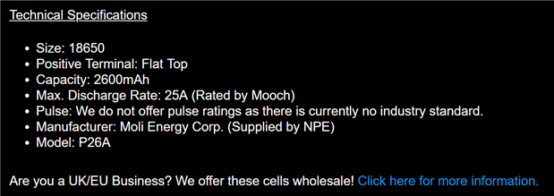

    I'm tempted to raise with trading standards, that these batteries are being sold with wording that they are 'authorised for use with vape devices' because that suggests some approval.
    I cannot find on the Molicel website where they specify that these cells can be used for vape devices: Molicel High Power Lithium Ion –Power Tool, Electric Vehicle, Solar Power
    So it would be good if they can check they really are recommended by the manufacturer (even though 'authorised' suggests some standard approval/authority!!).
    Some manufacturers of similar sized cells explicitly say they do not recommend for use with vape devices, e.g. this PDF doc from LG Chem: https://nkon.nl/sk/k/m36.pdf
    states:
    Also they state the minimum they expect in battery packs, otherwise they will not accept any liability:

    Calm down dude first off these cells are authorised for use in vaping devices and in the UK at least the law is very strict around vaping goods. Yes the site doesn't list the full data sheet, they are a trusted source for the best fully tested cells however if you need the full data sheet all you need do is email them like I did and they will happily provide you with the full manufacturers specification pdf. I would supply you with it but this forum doesn't allow for attachments.
  • michaelkellett
    0 michaelkellett over 7 years ago in reply to moderategamer
    You can attach indirectly by adding a link, I use a free Dropbox account for such things.
    I'm interested in Shabaz's info because it shows that it is expected that battery pack designs would need two faults to fail, and the system would then need three faults to a fire.

    Is this mosfet suitable for drain current of up to 20A max actuall drain more like 15A max?
    https://www.sparkfun.com/datasheets/Components/General/RFP30N06LE.pdf
    https://www.amazon.co.uk/Cylewet-RFP30N06LE-0-047Ohm-N-Channel-Arduino/dp/B071VXRQYR/ref=sr_1_1?ie=UTF8&qid=1552636322&s…
    I can link the datasheet for the 18650 cell if you want but I can assure you it can handle the load.
    I plan on using this fuse to protect the battery from over current or short circuit do you think it is suitable?
    https://uk.rs-online.com/web/p/products/7032795/
    I found this buck boost convertor designed for e-gigs/vapouriser was concidering using it, It's texas instruments so bound to be good, they supply the full spec sheet and also the full circuit diagram.
    PMP20327 Variable Outputs 2-Cell Battery 200W Heater Element Power Stage Buck Boost Reference Design | TI.com
  • michaelkellett
    At 15A the MOSFET will dissipate 15 * 15 * .047  = 10.6W
    At 20A it will be 18.8W - it will get hot - at 20A about 25% of the power is going into the MOSFET - so it's not a good choice.
