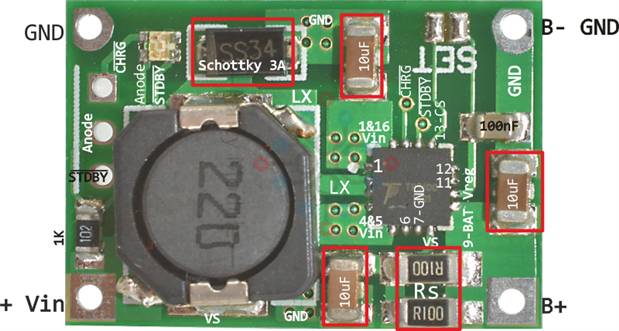

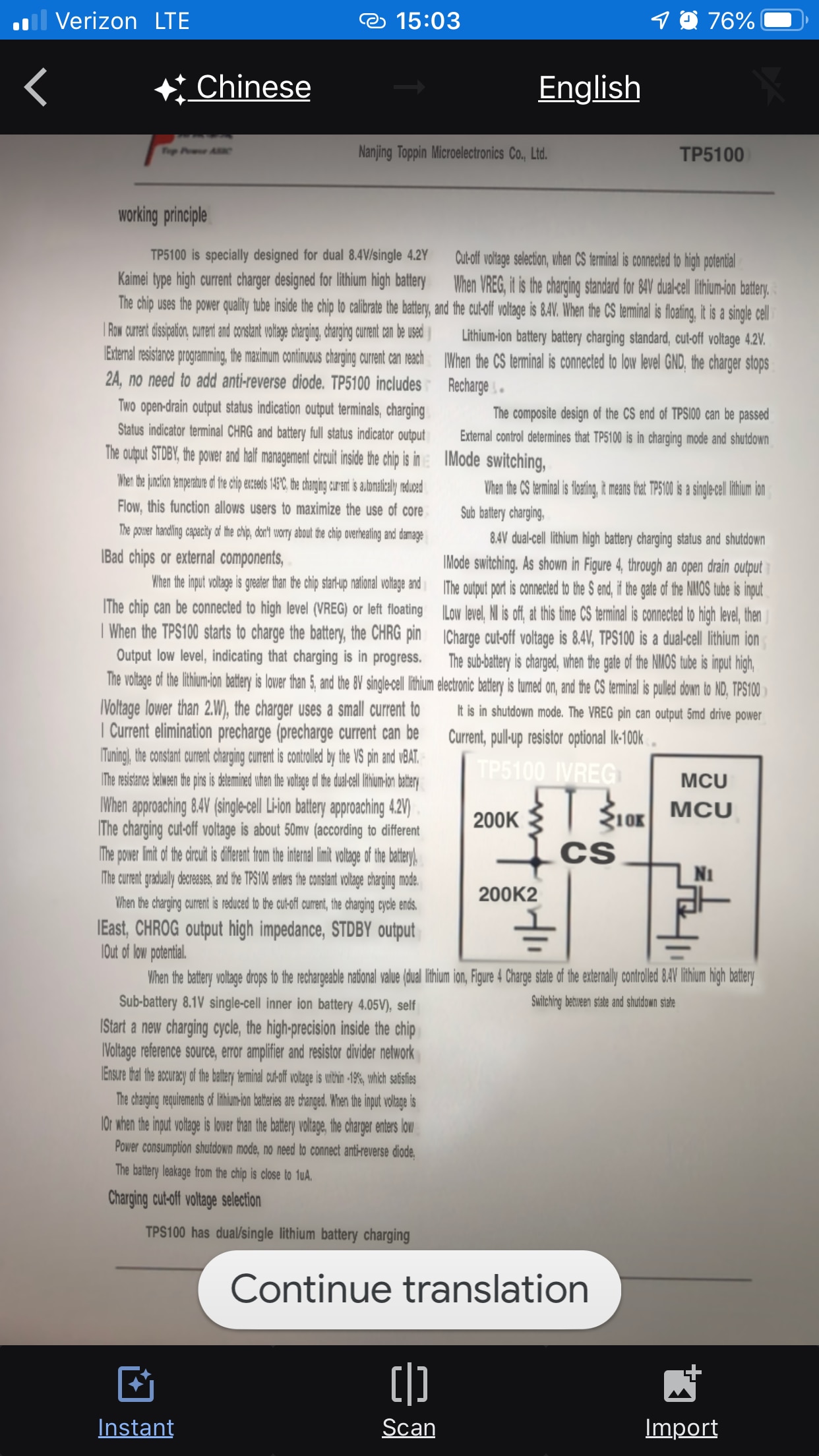

Hi, I purchased 10 of the TP5100 modules trough Banggood and already six of them failed miserably. (With all of them the TP5100 IC failed)

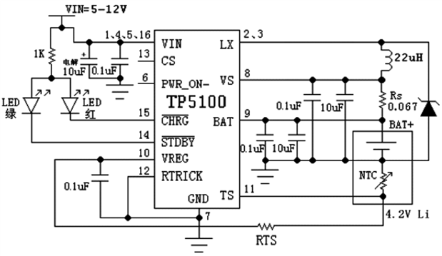

The problem seems to be with some external components and I studied the circuit and the badly translated document so I redid the document as well as I could.
The main problem seems to be with the Schottky, the SS34’s reverse leakage current maybe just to high for the IC (or maybe sub-standard).
Im planning to replace it with MBRS540T3G with an reverse leakage of 300uA (any suggestions of a Schottky with a DO-214AB package size) as a replacement for the four that survived. I'm also going to replace the remaining three 10uF caps for just in case and also the 100nF cap. I’m going to use a low ESR 10uF cap from TDK with a 10% tolerance (C3216X7R1E106K160AB). All the components footprint is the same as the current. I’m also thinking about replacing the two 100 mOhm resistor with a 1% tolerance 50 mOhm 1W resistor (MCS1632R050FER) (Rs) that is specifically for current sense purposes just to be on the safe side (The modules takes way to long to reach me to risk the remaining four and with sensitive devices like the LiPo batteries make it high risk)
The NTC that is on the diagram is not avaiable on the module and seems to be tied to ground with RTRIC for a 10% trickle charge current. The on board LED also have some pads for an external two color LED (common anode) next to the input. The PWR_ON is left floating as in the diagram. To enable 8.4V (two cell charging) the SET pads may be linked to establish a link between CS and the reference voltage at VREG.
I have improved the translated document on the TP5100 and made some notes in PDF format If you are interested.
Could you please give comments about the suggested changes. I just hate to loose the last four modules as this seems to be and good charging module

    Something else I failed to mention, The failure to the IC occurred even before I added the 18350 LiPo Cell It happened directly after I applied a 13.8V supply to the module. The supply is a Regulated step…

    It seems that the biggest problem here may be the input caps. On the original diagram indicate two capacitors on the input line, a pre-charge cap (from the circuit explanation) and a supposedly decoupling capacitor both between the V+ line and ground. The interesting fact seems that the pre-charge cap on the diagram is an electrolytic of some sorts (+ on the one side may indicate an electrolytic) and not a non-polarized cap (most probably a multi layer ceramic). The explanation of the circuit (as far as I could translate) the pre-charge cap could be anything between 1uF and 10uF. In the module however there is only one capacitor, a non-polarized 10uF cap. This omission may be to save costs and circuit area as I found that a 10uF SMD tant is quite big, especially the 35V (which I presume should be the minimum work voltage cap) and it is quite expensive. I made this alteration by adding a 10uF 63V radial electrolytic (the only one I had available for the experiment) by soldering it at the bottom of the circuit between the V+ and ground. The 10uF non-polarized cap between GND and Vin at the top I replaced with a 100nF 1206 multi-layer ceramic cap. (I will use a 10uF 50V SMD Panasonic 5 x 5.8 SMD electrolytic soldered to the bottom of the circuit between Vin and ground, for the remaining two modules I have left, part no EEEFK1H100UR) Furthermore, according to the circuit diagram there should be a 10uF and a 100nF non-polarized cap between both the BAT and ground and VS and ground (reason unknown) but this is not available on the module where it only seems to be a 10uF non-polarized cap and not the 100nF non-polarized cap. To be on the safe side I also added the two 100nF caps, one 0805 100nF where the one of the 100mOhm resistor is between the Vs and the ground of the 10uF cap, and one 1206 100nF between the B+ and the ground at the bottom of the PCB. At this stage it seems to work very well as the module did not fail (so far). I agree that the 2A charge rate may be a bit to high as the 18350 get a little bit of a temperature rise (still not alarming hot but just a little bit warmer than the ambient) but to save the battery life I will replace the current sense resistor to either a 1W 68mOhm (Panasonic ERJ8BWFR068V) or a 1W 100mOhm (Panasonic ERJ8BWFR100VERJ8BWFR100V) 1206 1% resistor specifically designed for current sense applications. I did not replaced the Schottky diode (SS34) at this stage as the one that I ordered (SMC package) is quite too large. I will be ordering a DO-214AA (SMB) package with a lower forward voltage drop than the existing one ( item number B340B-13-F) just to be on the safe side.
    At this stage adding a NTC may be just possible by redesigning the whole module as it seems that pin 11 and 12 is tied to the ground at the bottom of the IC.
    But so far so good, I hope it help a bit to sort out this modules inadequacies.

    @OPHow are you doing with these? I really cannot see how changing the capacitors could make any difference, except maybe for the case of the output for stability. Even then the addition of the battery should negate this and I suspect your most likely issue is either faulty IC's or that flyback diode. I have also gone through a few of these boards. Very frustrating because devices like this are normally quite reliable. QC clearly is not testing at full voltage! I have not tried with single cells yet but I do not need it for this purpose so I do not see the point. I have ordered some of the IC's themselves but as I do not know if they are the original source or not it may be pot luck as to whether this makes a difference!
