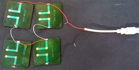

Hello everyone. I have a DIY question for anyone who can help. I got the idea from a youtube video...http://www.youtube.com/watch?v=TrSUwZciExE
I'm constructing a USB solar charger using some old solar cells from garden lamps.
Each cell has an output of 2.3 volts.
I connected 4 cells together and I end up with a total output of 4.6 volts.
I connected a female USB port to it, then an iPod. It charged for about 30 seconds then stopped in full sunlight.
I thought maybe there wasn't enough voltage so I connected 2 more cells and I still end up with 4.6 volts and it wont charge.
I checked my connections and looked everything over and I didn't find anything disconnected.
Here's a picture. Anyone with advice?
Thank you in advance.image
    0 e14 Contributor over 15 years ago
    Do You have power supply with variable Voltage? It'll really help You.
    You need test minimum voltage for charging and current at this voltage. Next step is V-A charasteristic of your solar panels.
    If iPod have some detection for 5.0V you can join more panels to get 6.9V and use 7805 to get exatly 5V.
    Good luck with your project. PetrH
