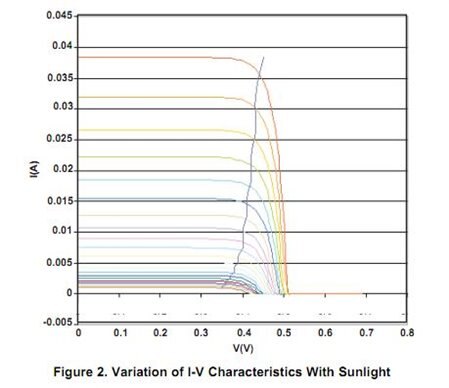

I'm trying to figure out what the best solution for charging a 6V lead acid battery from a 9V peak power / 10.8V O.C circuit solar panel. On cloudy days, the 5W solar panel will put out anything from 20 - 60mA at 6V (tied to the battery). In the winter in some locations, these conditions will persist for weeks at a time, so making the most of the current all of the time rather than making the most when it is sunny is more important.

I don't expect using a switching design vs a shunt design to give a large advantage - Assuming full sunlight, a shunt system this utilises approximately 68% of the energy (vs MPP) from the panel charging directly (running at 6V would mean 0.275V / cell vs MPP of 0.42V / cell, so reading off approximately from the chart in this datasheet http://focus.ti.com/lit/an/slva378/slva378.pdf  and comparing 0.42 x 0.036 = 0.0152 vs 0.275 x 0.038 = 0.0104       per cell). Switching designs would have to exceed this efficiency figure across the range, especially at the low end.

    Not sure I'm really understanding your problem but do have some experience with low power 12V installations. My understanding is that the solar cell (within the bounds of it's maximum O/C voltage) behaves as a constant current generator whose output is proportional to the light intensity.  Therefore, connection to a lead acid type battery may simply achieved using for example a LDO low quiescent current linear regulator to limit overcharging, crude but simple. For example I've used an LP2952 with output blocking diode (shottky). Losses are the volt drop in any non return diode(s), the LDO forward voltage drop, the LDO quiescent current.

    Hi James, thanks for your reply. The real issue is using a LDO on it's own lacks several things:
    1/ Temperature compensation - this is required so that it is not overcharged in hot weather or not charged adequately in cold weather. It can cause gassing if overcharged and may permanently affect the batteries capacity.
    2/ Quick charge and float charge. If the LDO is set to just the float voltage, then when there is lots of sun available, it won't take full advantage of it as it may not charge as quick as it could. Charger IC's normally fast charge at a higher voltage until charged and then drop back to the float voltage. I believe a charge above the float voltage occasionally can help rebalance the cells internally if they are normally charged at float voltage too.
    3/ Pre-conditioning charge - If the battery has been discharged more than optimally, then charging it at the full current may just cause heating. Trickle charging it until it reaches a certain potential will avoid this problem.
    I need to look after the battery as much as possible, so a charge controller IC is preferable. Although I could roll my own solution, it will take significantly more time and effort and I just don't believe there isn't a solution out there already!
