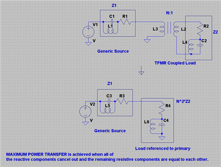

I need to match impedance with the primary side of a transformer. The electricity applied to the transformer will change in frequency, so I need a way to keep the impedance matched.
As you know,  a transformer coil is like inductor, and a capactor was the best solution. I did this before with Thomas Edison style trial and error, and eventually found a capacitor to do the job. But I want a more calculated way to do so. Any thoughts, experiences, formulas?

  • Jorge_Garcia
    0 Jorge_Garcia over 15 years ago in reply to Eavesdropper
    Hi E,
    You can't have maximum power transfer from one side of the transformer and not the other. Remember that transformers are impedance converters, as such the impedance on the primary is a scaled version of whatever impedance is seen on the secondary, if you don't have a match on the primary you don't really have a match on the secondary. This is true if you are using a transformer that can be modeled as close to ideal.
    You haven't given many specifications, so I'm kind of giving you general guidelines. The varying voltage is not as critical an issue as the varying frequency, remember that the reactance of capacitors and inductors varies with frequency so a match at one frequency will not result in a match at another.
    In order to get an optimum match you need to categorize your source's impedance and your load's impedance within the frequencies of interest. If you can do that then designing for an optimum match will be trivial and I can help you out with that.
    If it's not super critical to get the optimum then you have to determine what type of load is seen at the transformer primary is it inductive or capactive. In most cases the load is inductive, so we are going to add capacitance to achieve max power transfer, this procedure is empirical but I think it's better then brute force trial and error.
    You'll need some means to measure the power entering the transformer as you perform the experiment.
    First measure the power entering the transformer
    Add a properly rated capacitor of some suitable value (1-10uF for low frequencies, 1-100n for high frequencies)
    Did the power increase? If it did then double the capacitor value and test again. If the power increases again then again double the cap value and measure. Continue this procedure until you see the power drop. Once you run into this situation the ideal compensation cap value is between the value you just tested and your previous tested value.
    If the power decreased? That means you added to much compensation capacitance, halve the value of the capacitor and try again you should see the power entering the transformer increase, continue halving until the power dips. Once again the ideal compensation cap value is between the value you just tested and the previous tested value.
    Once you have a range you can perform a similar procedure to zero in on the maximum power point. This is basically a binary search you're still brute forcing it a little, but the force is a little more directed.

  • Eavesdropper
    0 Eavesdropper over 15 years ago in reply to Jorge_Garcia
    Jorge,
    That is quite extensive reply, thank you so much for the information. I tried the capacitor matching, I am getting closer to my goal. I need more caps. I agree it is a little brute force, much like how Edison experimented, but that is fine with me.
