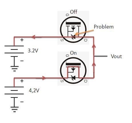

Good Morning,
I have a problem with a electronic project. In this project i have measuring and control two batteries . The problem is that supply output is the same and when i use mosfets, the body diode of  mosfet of other battery don't block the voltage when the voltage of other battery is less.
I can´t use diodes in output because the drop voltage it's big for batteries of 3,6V.
I searched in the electronic manufacturing, but the products that i found it's low  power current <500mA (i need 1A) or they have highest quiescent current (i need <10uA).
Can help me to solve this problem?
Thanks

    Linear Technology make a rnage of "perfect diode" control chips of which this is one (may not be the best for you - check out their website)
    http://www.linear.com/product/LTC4357
    MK

    If you only want to run from the source with higher voltage, just flip the MOSFETs around.
