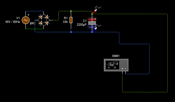

    I threw this circuit up on to 2 different circuit simulators i have and the results was the same, around 61.9 volts both times.
    Please point out anything that i have wired up wrong in this circuit.
    If this circuit in my pic is correct, ill try and break it down .
    P.S. i just used 45v AC at 60hz

    I wonder what happens if you multiply 45 by the square root of 2? Wow, it's really close to 61 image.
    45 Volts RMS produces 63 peak, which when filtered should be close to 63 Volts.
