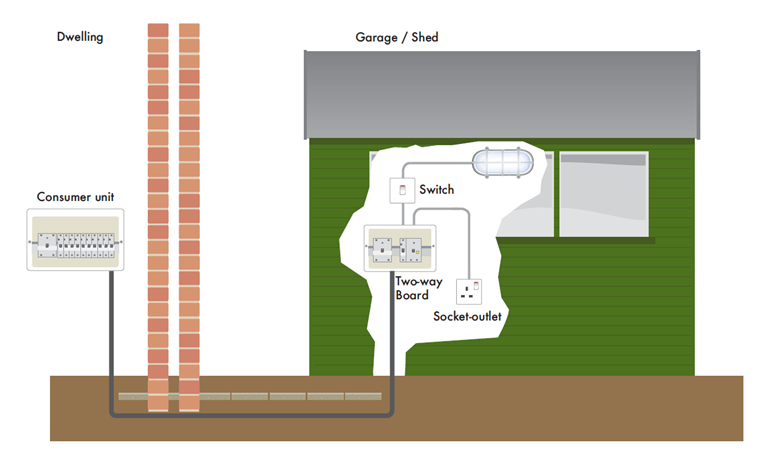

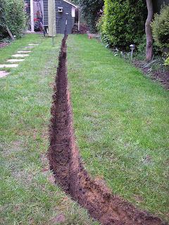

    At the house end there is a RCD followed by an MCB. At the workshop end there a distribution box with another RCD used as an isolator (which I'd not turned off as I needed the lights on) followed by one MCB for the lights and one MCB for the sockets. The outdoor section is SWA in a 19inch deep trench, an electrican put that in for me and I was adding an extra socket in the shed using metal sockets and more armoured cable.
    Trench.JPGimage

    Great that you've worked it out and really nice drawing.

    The diagram is credit to the IET wiring regulations magazine
