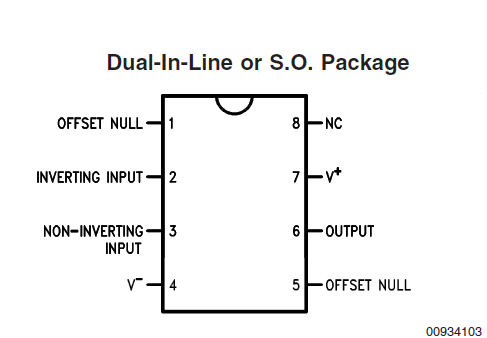

    Another thing you could check would be to see if the low voltage rail is working. You can do this by reading the power pins on the LM741 ICs.
    As you can see pin 1 is designated on the notch end or from some manufacturers is designated by a dot. Put you meter on DC Volts and take a reading between pin 7 and pin 4. You should have somewhere between 5 and 18 volts is my best guess. This voltage should be present even if the unit has shut down for other problems like an over load condition. For our quest for repair of this unit no voltage would mean we need to trouble shoot the power rail that runs the internal electronics. If we have voltage to the 741s we will have to go looking for a reason the internal brain has decided to shut down the output.

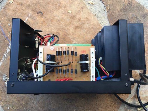

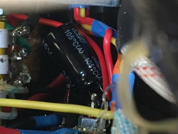

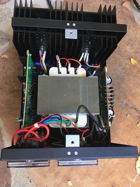

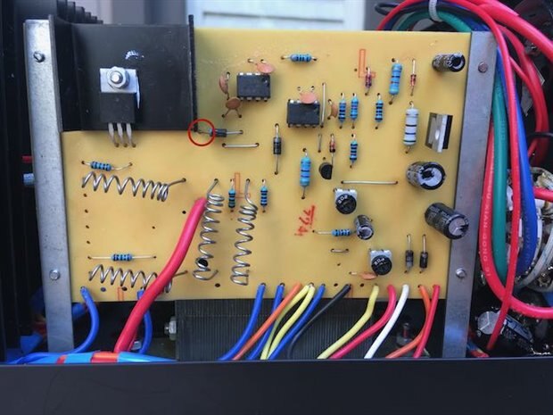

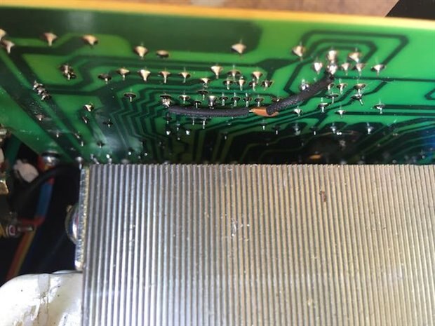

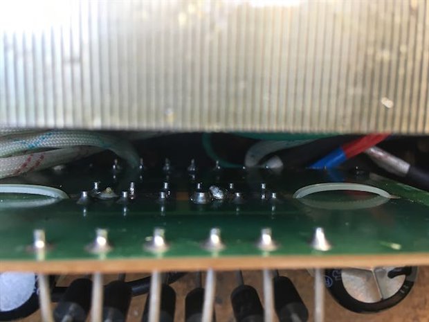

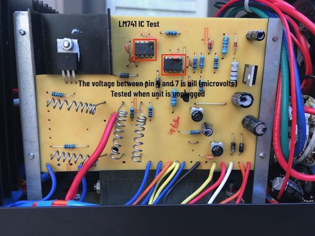

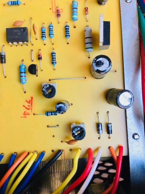

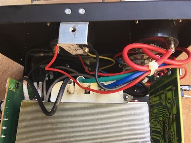

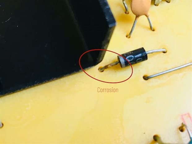

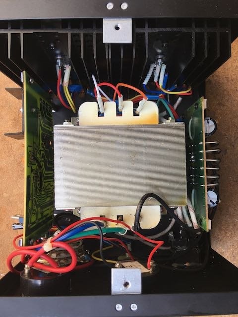

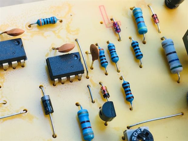

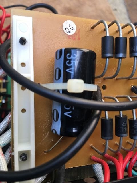

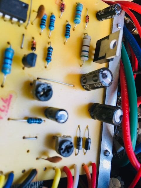

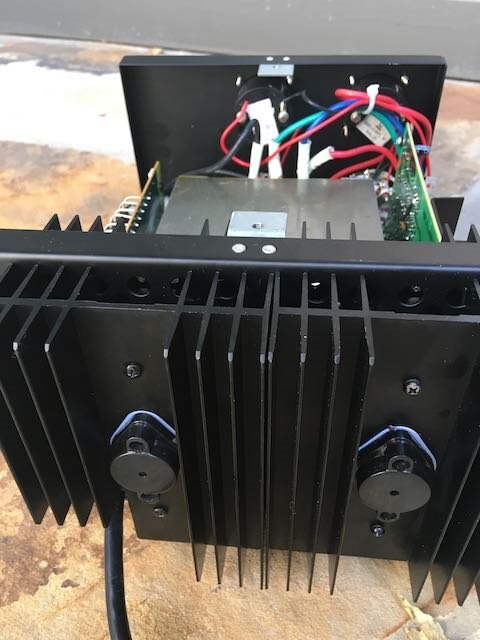

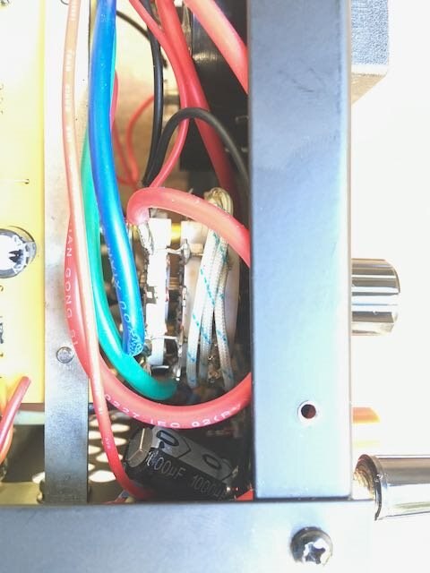

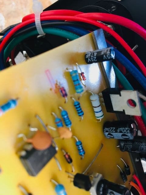

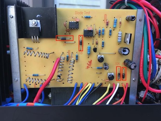

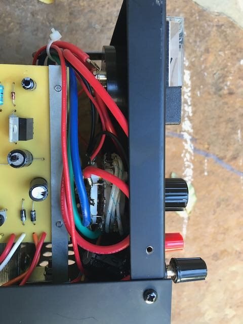

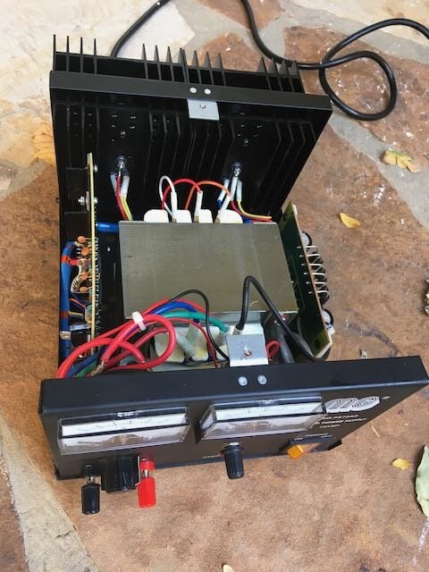

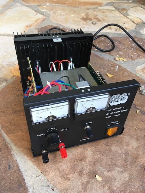

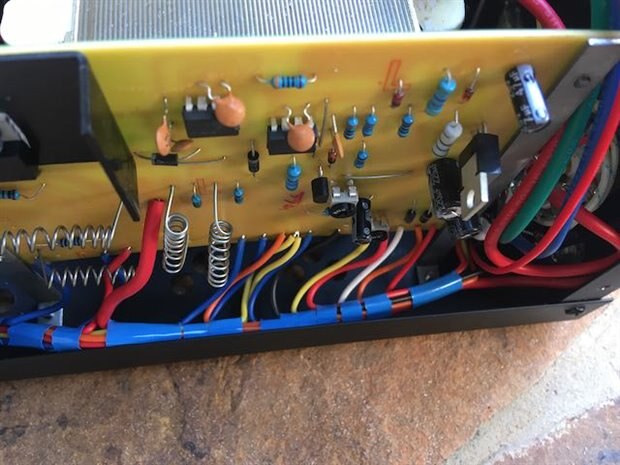

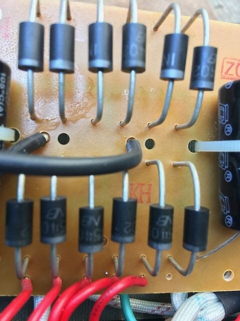

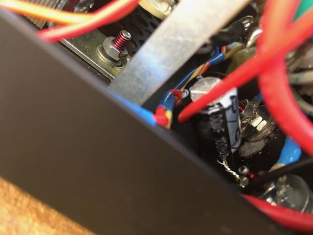

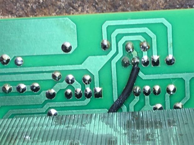

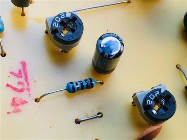

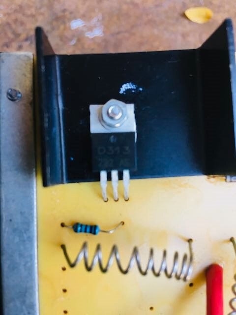

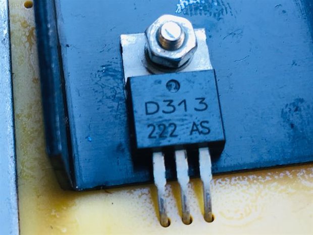

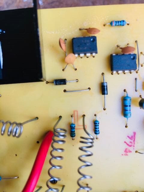

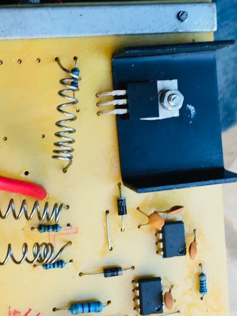

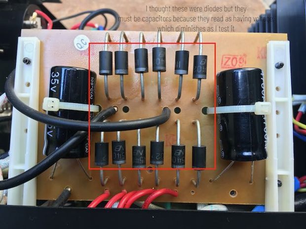

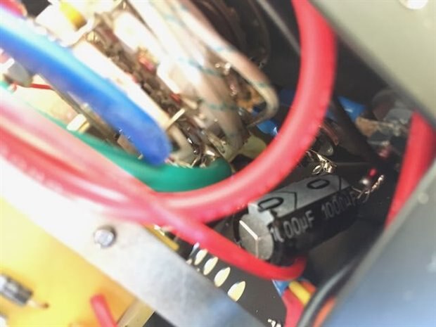

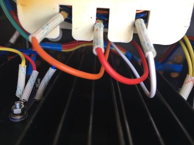

    0 mpulliam over 6 years ago
    Thank you John for the detailed instructions.
    I will try to attach pictures that I took today.  I think I have a bad diode to start off with. (a camera is a good inspection tool as it turns out)
    I unplugged the unit and performed the diode tests, the LM741 IC tests, and wrote down the measurements in the pictures below.
    I shorted the capacitors and tried to test them but the readings were all over the place, I'm not sure what was going on?
    I haven't tested the transistors yet as the power transistors? in the back of the unit are difficult to get to, unless I could test them from inside the unit?
    Thanks for your help,
    Matt
