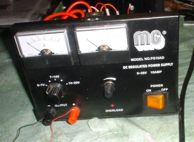

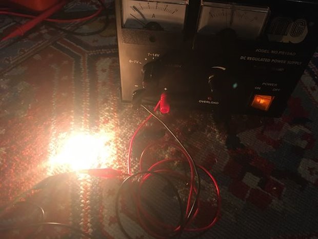

Hi.

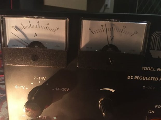

I just bought a lot of Slot Car stuff, yes those cars that go around a track. The guy was serious about his hobby he didn't have the usual wall plug in power pack, he used a MG Electronics PS-10AD, 0-20 VDC at 10 Amps. Well this power supply doesn't work anymore. It does turn on and the red overload light stays on. It doesn't put out anything. I used my multimeter etc., nothing. I know that these are made overseas . They did retail for about $200. So the questions is were can I get it repaired OR should I ? I'm in Western MAss.
I did check the fuse , it's fine. I've got a heavy door stop on my hands, it does have a nice handle and cord on it !
Many thanks for info, Ted

    mpulliam over 5 years ago in reply to jw0752 +4 suggested

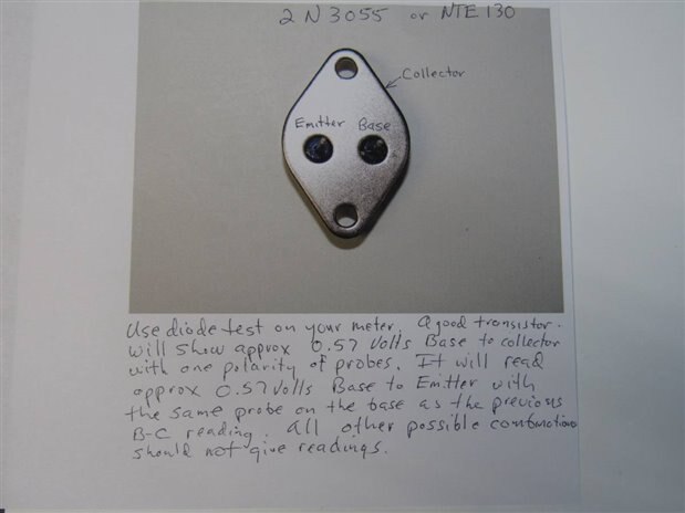

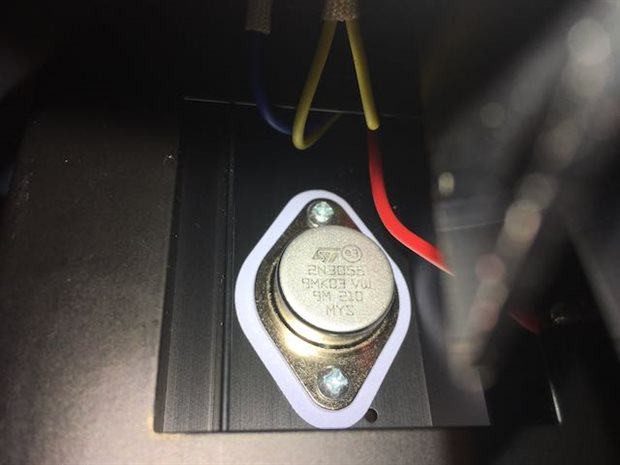

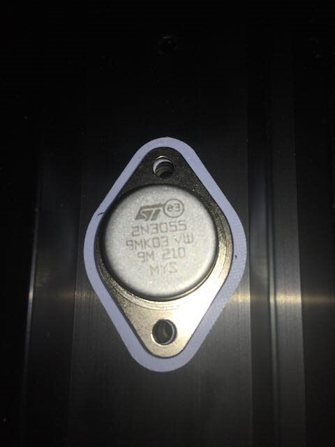

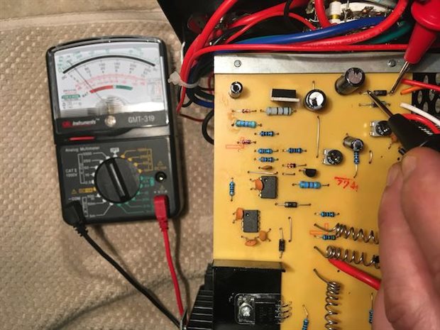

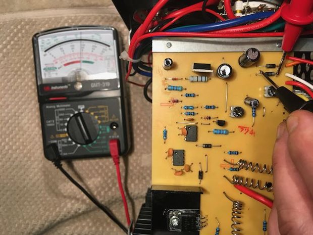

    Well, I spent all day replacing four 2N3055 transistors....it wasn't easy and... Success!!!

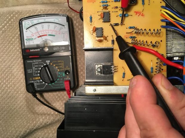

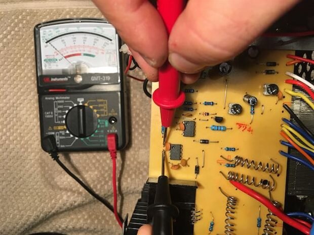

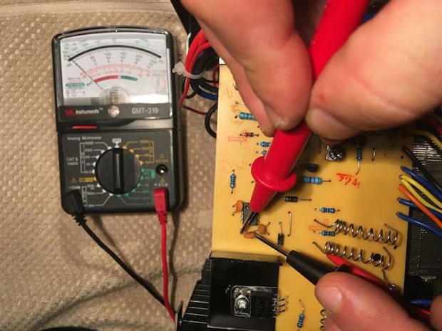

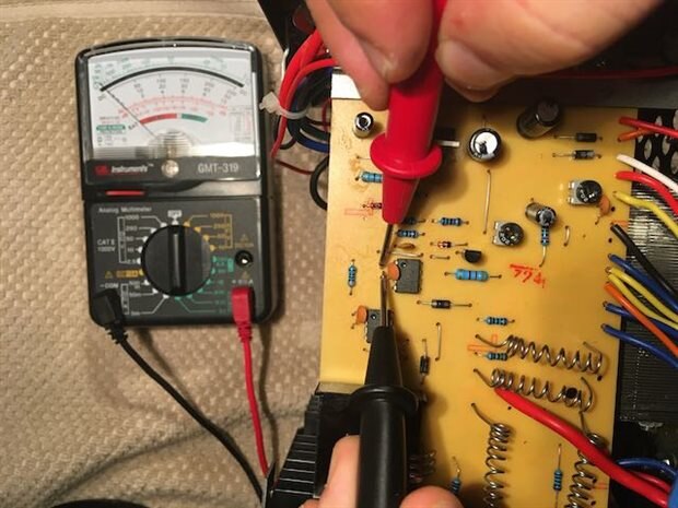

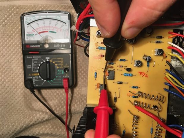

    Hi John, I have a thought. If the output transistors (or is it pass or power transistors?) NTE130 or 2N3055H are giving a bad voltage reading in the voltage test, could it be that any component between…

    BTW I tested the old 2N3055 transistors, the continuity is the same as a new 2N3055 . There is no continuity between any of the terminals But when I run a diode test, a new 2N3055 tests at .486 volts with…

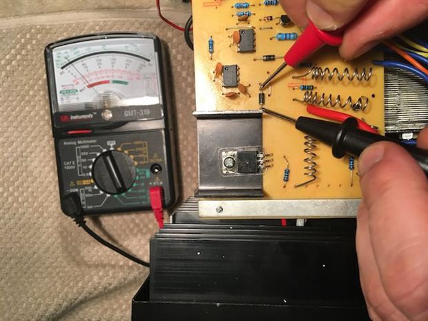

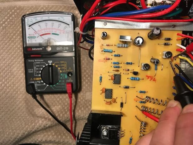

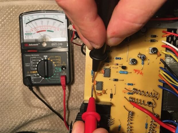

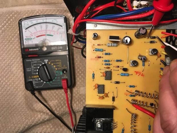

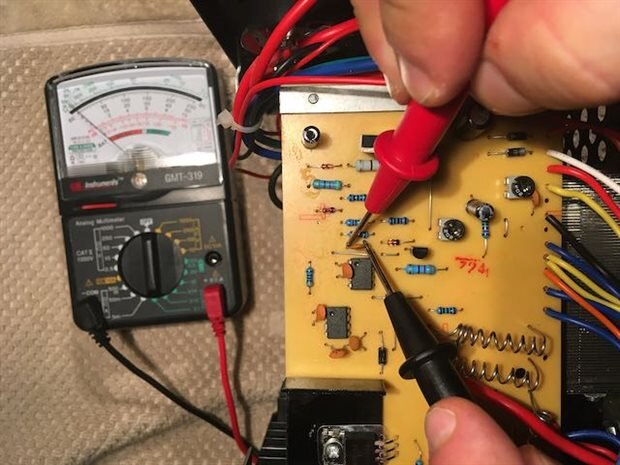

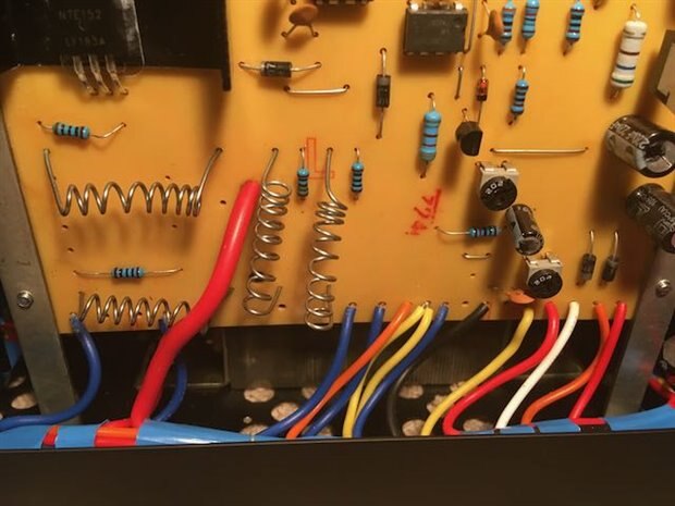

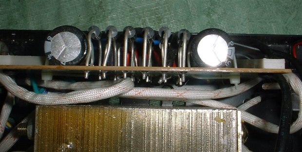

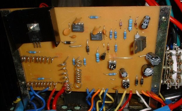

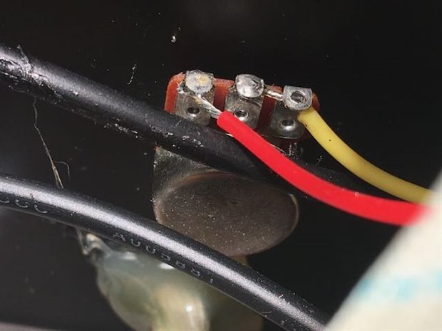

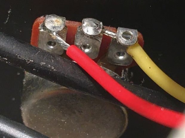

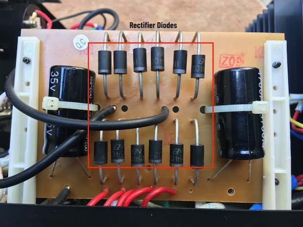

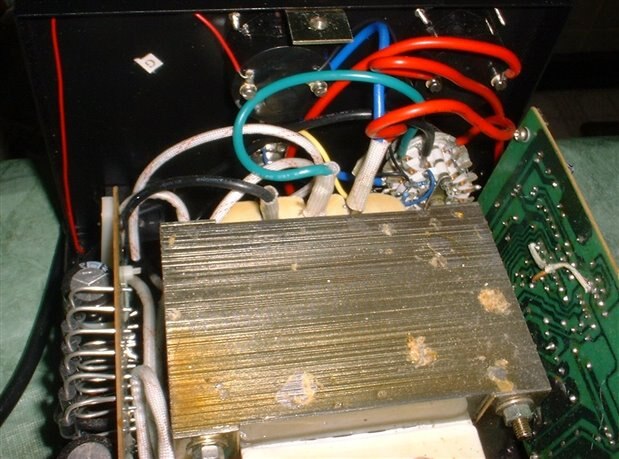

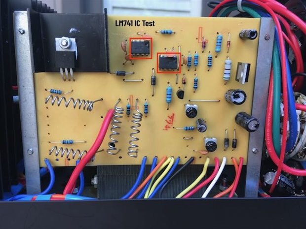

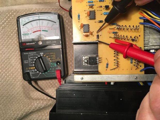

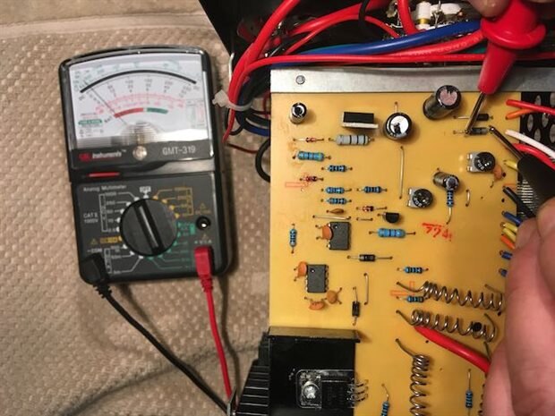

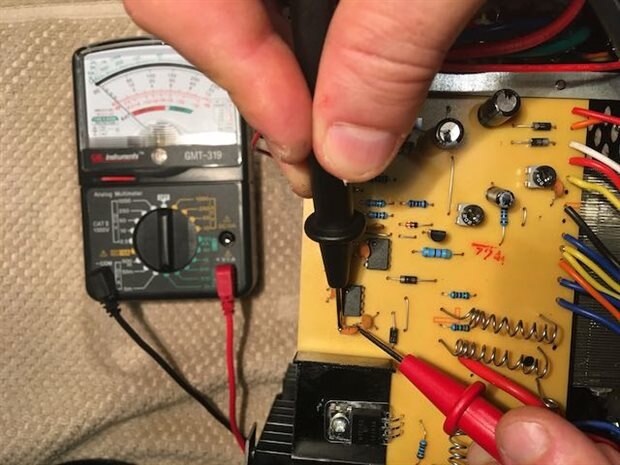

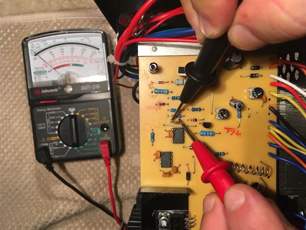

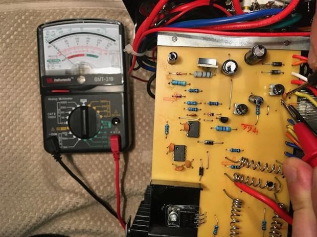

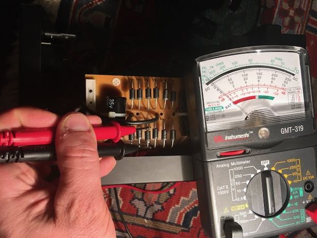

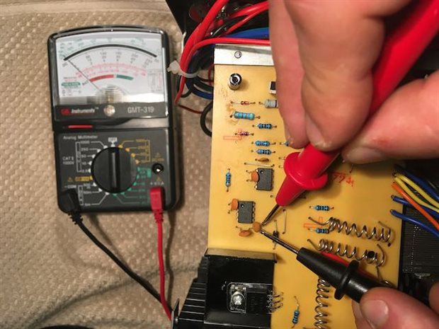

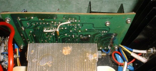

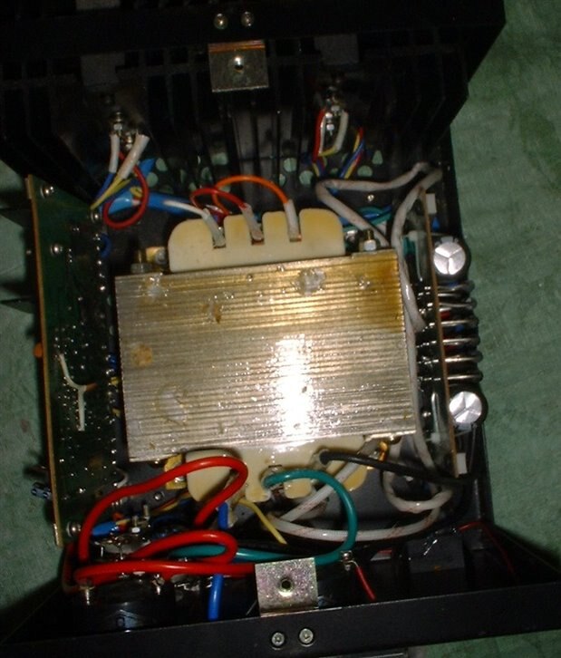

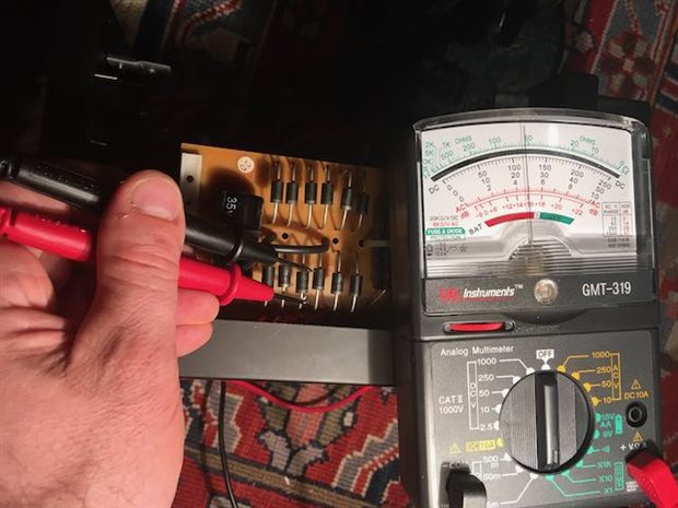

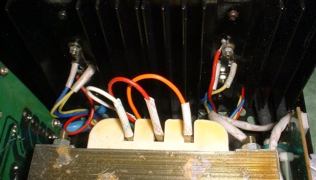

    I did open up the MG Electronics Power Supply . I have attached pix of that expedition!
    What I found was....No burnt anything, no burnt smell, no heat, no buzzing noise, nothing looks incorrect, it pretty clean in there!

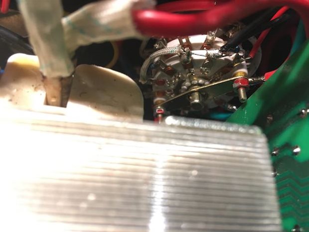

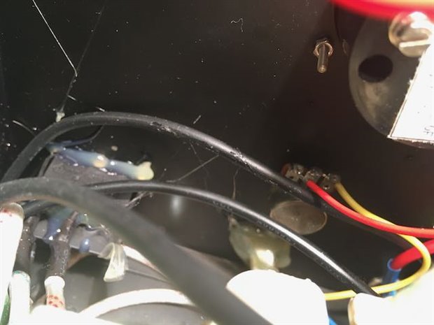

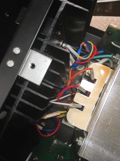

    I did see what I that was melted something on the giant transformer, I took a Q-tip to it, nothing. Probably tried glue or sealant of some kind !
    Visual I see nothing! I did check the fuse again, it's fine !
    So what usually goes first on a power supply ? Just a reminder, the overload light is on, what ever that info is worth !
    Thank you all so very much !!
    Ted

    0 D_Hersey over 11 years ago
    I gotta make some guesses since we don't have the schematic at hand.  If I'm wrong, it doesn't mean I am a dummy, it just means I'm wrong.  Now, if you would just explain this to my wife. . .

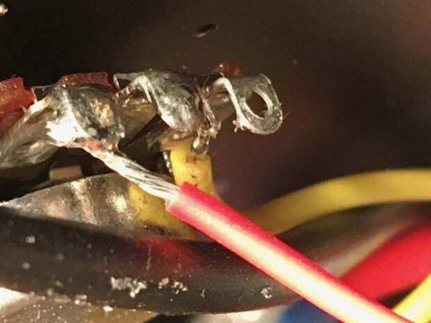

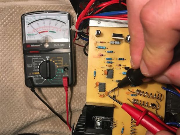

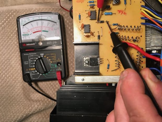

    Okay, this thing is really made of discretes.  It is an oldie, but nice and well worth fixing.  This is good, everything is explicit.  The two chips are 741 op-amps, the same chip that governed the Love Controls at my first job.  Take heart.  Notice that the bridge rectifiers are made of discretes.  There is one wire there, that when soldered caused the insulation to bulge from excessive heat.  It will work fine, but it shouldn't have passed Q/A.
    I think one 741 is acting as a feedback controller for the supply and the other is a comparator for the overload function.

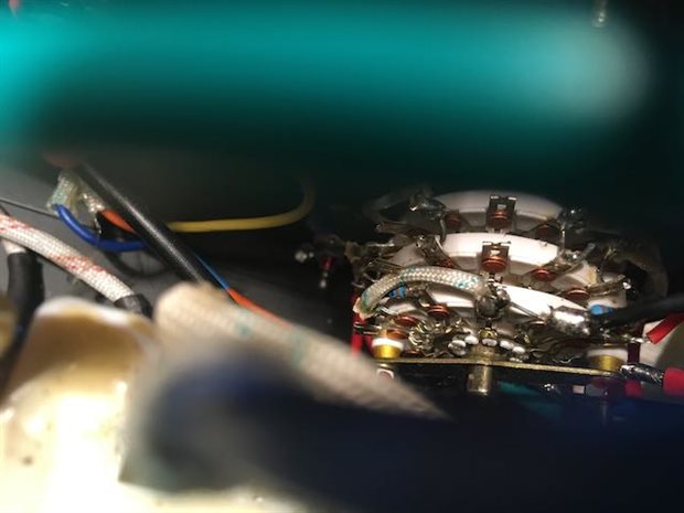

    Going for a quick kill, see if you can pull the covers off the power transistors on the back of the unit and find the part numbers for them.  If they are bipolars, they will be fairly easy to test, if they are Darlingtons it will be a wee bit tougher.

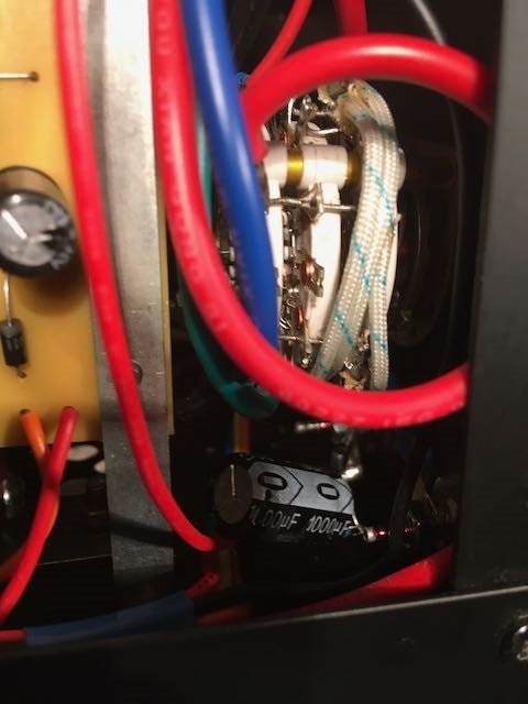

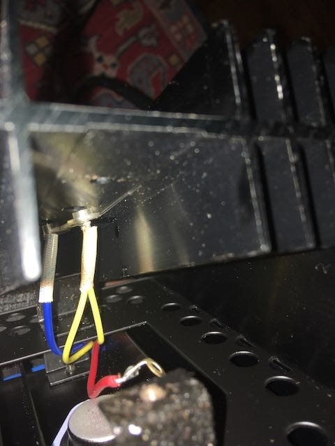

    0 e14 Contributor over 11 years ago in reply to D_Hersey
    I attempted to take the covers off the back 2 power transistors. Those caps are held on by a lock nut and nut on the opposite blind side. I can't get them off. I had one set of nut and washer fall off that's how I know about connectivity. I haven't ventured into taking off the giant heat sinks in back. I can see the screws. I don't know how things are connected. Are the power transistors just pushed into place and not soldered ? If I attempt to take off the heat sinks will the power transistors come with it and there will be a wires connecting everything together ? I just don't know.

  • D_Hersey
    Don't worry, make sure you have a clean, well-lit workspace, there is nothing proprietary or expensive about any of the parts here.  Those look, from here, to be to-218  packages, which have been supplanted by to-220, not to worry.
    The transistors are in sockets.  If you remove the screws (being careful to recover all of the washers) the sockets will hang on their wires, and the transistors can be pulled out.  There might be an insulating mica sheet to be careful of.  On the off chance that the transistors are different devices, you might take a picture in order to help us keep things straight.
    Can you test with an ohmmeter or continuity tester to see if these two transistor are wired in parallel or not?
  • gpsmikey
    0 gpsmikey over 11 years ago in reply to D_Hersey

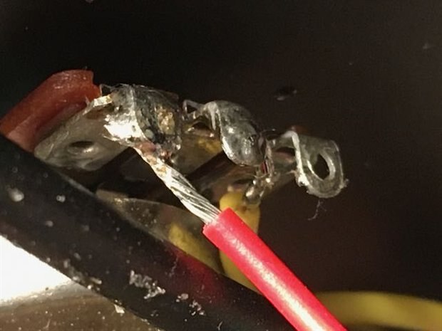

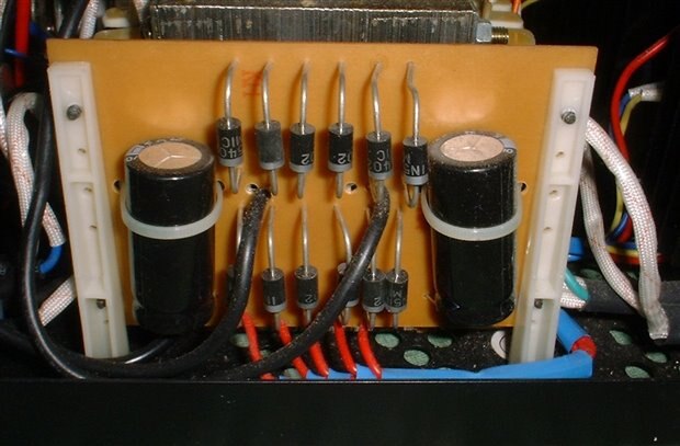

    One thing to check - second image down, one lead of the diode is against the filter cap and looks like it caused the insulation on the cap to melt when it was soldered.  If that lead is NOT ground and is against the cap, it may have shorted to the shell of the cap (which is most likely ground).  Make sure there is not a short there.
    mikey
