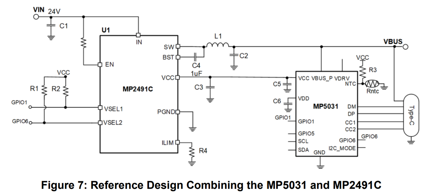

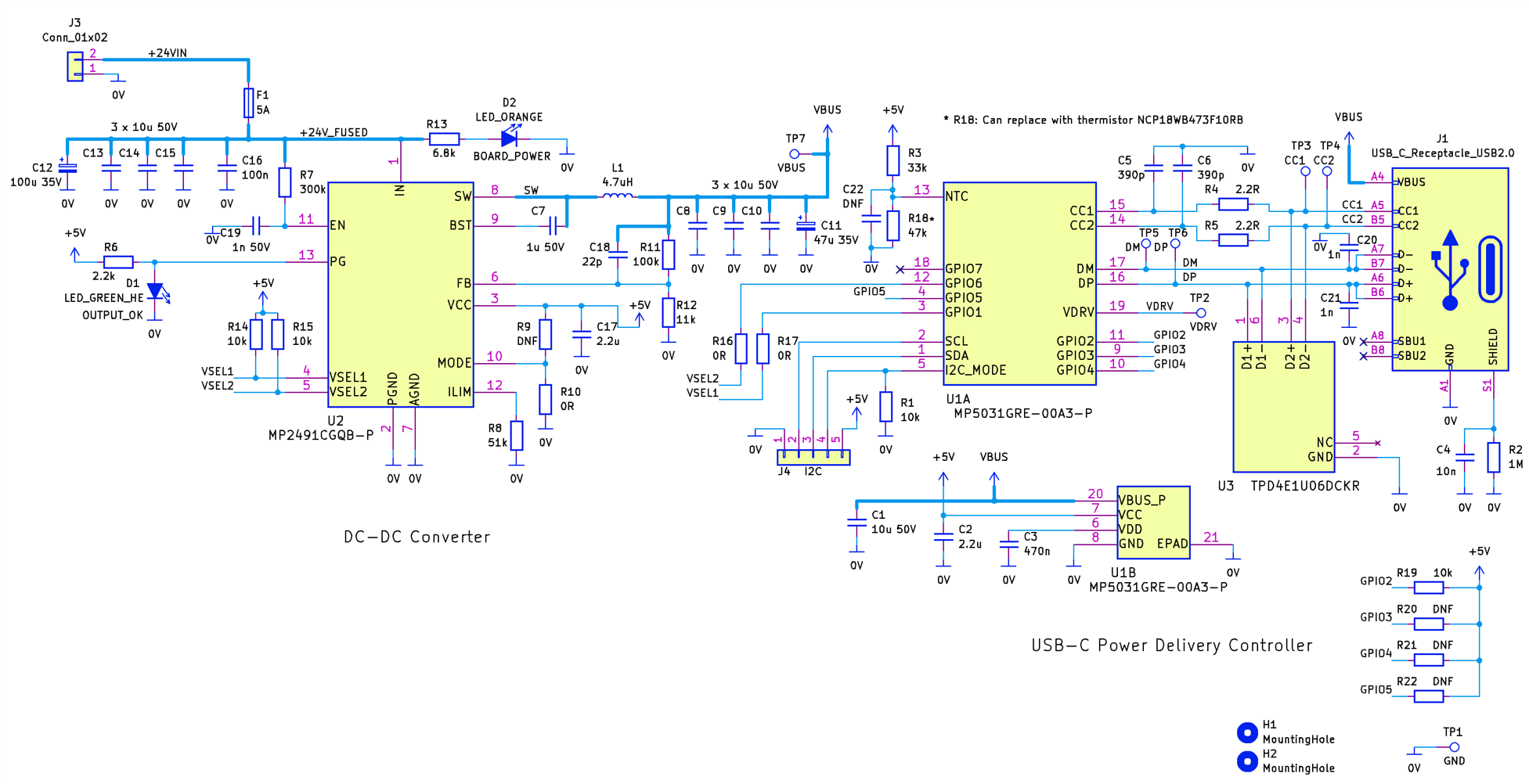

A USB-C circuit consisting of a DC-DC converter and a USB-C Power Delivery controller isn't functioning as expected. According to the PDF datasheet of the MP5031 USB-C Power Delivery controller chip, the chip has a default configuration, but I need to program via I2C certain register settings so that it functions with the MP2491C DC-DC converter chip I have selected. The I2C registers are supposed to be one-time-programmable (OTP), so if I program them incorrectly, the chip needs to be desoldered and replaced with a new one. I don't mind doing that, but only if I definitely have messed that up.
The specific IC I am using is part code MP5031GRE-00A3-P.
I have programmed the I2C register settings in the manner that I thought was correct. After programming, I read the settings and verified that they were what I expected.
All good so far. However, after I reboot, and re-read the I2C registers, the settings are back to the defaults!
There is this snippet in the datasheet:
"These registers are one-time programmable (OTP). If the MP5031’s VCC voltage (VCC) exceeds the UVLO rising threshold, then the OTP items are loaded to the I2C register."
I have (of course) checked the VCC voltage, and it is 5.01V which is what it should be. So, now I'm unsure what to do : ) I don't want to attempt to re-program the OTP registers, in case that messes things up. Besides, I'm pretty confident they were programmed because, as mentioned, I read the registers after programming.
The Circuit
My circuit was based on this diagram:
My actual implementation was this (click the diagram to enlarge it):

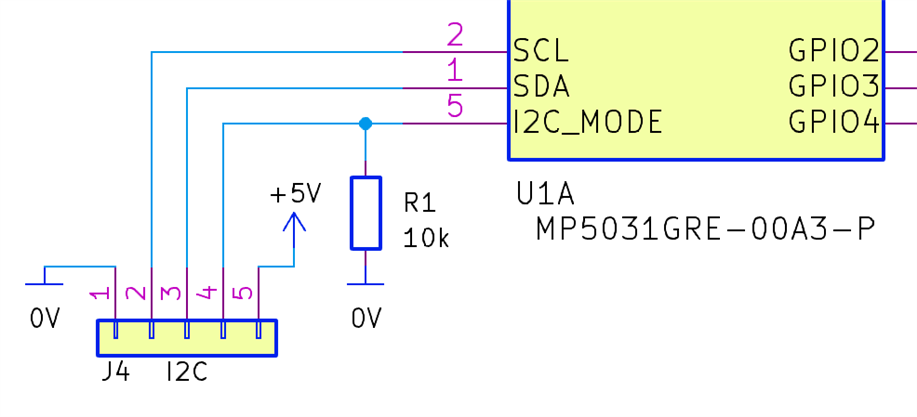

To perform the configuration, I used the connector J4 in the circuit, snippet:
I shorted pins 4 and 5 of the connector (so that I2C_MODE was high which enables the I2C slave), then powered up the board, and then performed the I2C operations using a microcontroller.
The registers inside the chip are all 16-bit wide, and the register addresses are 0x00 to 0x14, with 0x13 missing (it is undocumented, so I didn't read or write that address).

    shabaz over 3 years ago +6
    From some preliminary feedback, it turns out that my understanding of OTP (one-time programming) is not compatible with MPS understanding of OTP! It was not obvious at all, that the chips are _already_…

    MP4245), then the MP5031 operates in I2C
    master mode. Select I2C slave mode to configure
    the I2C register.
    Float the I2C_MODE pin or pull it to GND to set
    the MP5031 to I2C master mode. Pull
    I2C_MODE to VCC to set the MP5031 to I2C
    slave mode. The digital clock is always on in I2C
    slave mode (I2C_MODE = VCC). The I2C is
    active once VCC exceeds the VCC UVLO rising
    threshold. The Type-C sink does not have to be
    attached.
    The GPIO5 and GPIO6 pins can be configured
    as a second I2C slave entrance. However, the
    internal clock must be turned on for full I2C
    functionality. The SDA, SCL, GPIO5, and GPIO6
    pins cannot operate simultaneously in slave
    mode (see Table 6).
