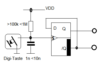

    0 geralds over 2 years ago
    try this circuit:
    use the D-FF e.g. CD4013, which you can use with 12V.
    a datasheet
    ti.com/general/docs/suppproductinfo.tsp?distId=10&gotoUrl=https%3A%2F%2Fwww.ti.com%2Flit%2Fgpn%2Fcd4013b
