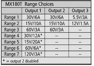

    AimTTi MX180TP
    imagealso with full LAN control
    Used less often but good when higher power is needed.
    Both of these supplies are quite easy to use under manual control and easy to programme via Ethernet or serial port.
    The metering (especially on the QL564) is quite accurate. The ergonomics could be  a little better on both supplies  - a rotary control per channel would be good and the QL564 would benefit from a better display.
