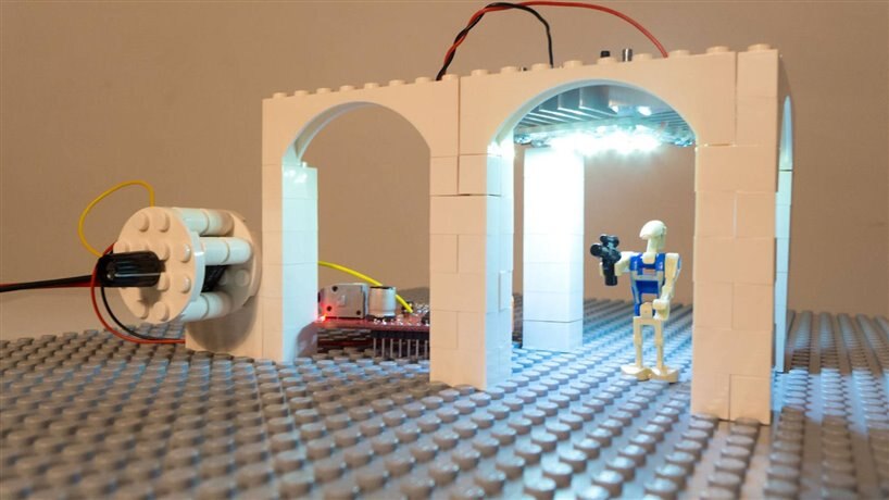

Here it is, in a lab simulation (there is a video showing the dimming effect near the end of the blog post). At full brightness the LED module is blindingly bright – about the same brightness as a 100W light bulb but consuming a quarter of the energy. Three of the modules can be controlled from a single Infineon RGB LED Shield.

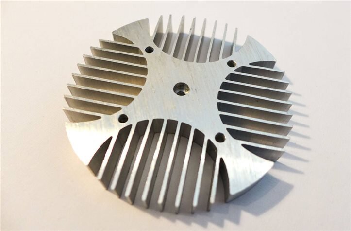

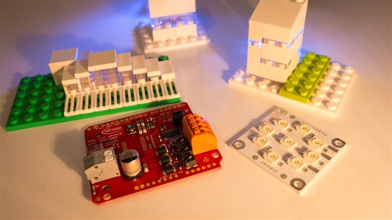

The RGB LED shield is designed to provide a constant current (configurable in software) up to around 780mA. Some of the most popular high power LEDs are typically designed for continuous operation at either 350mA or 700mA depending on the particular device. I decided to use 700mA LEDs. They can get hot and so they require a heat sink. To get heat away from the LED, often metal core PCBs (known as MCPCBs) are used. It is easiest to just purchase a module that contains LEDs already soldered to a MCPCB. I chose a Vishay LED moduleVishay LED module incorporating nine cold white LEDs (cold color temperature LEDs usually emit more light than warm color temperature LEDs; bathrooms may be better with cold color temperature lighting as an example. For now, I chose cold).
The heat sink was a low cost part from eBay, available from sellers in China. Four holes were drilled to secure the LED module, and a recessed hole in the center was drilled for creating a mounting point.

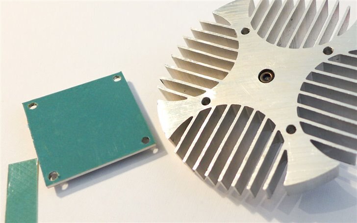

Due to surface imperfection some sort of thermal interfacing is needed between the LED module and the aluminium heat sink. Heat Sink Compound is one option. Instead I used some adhesive thermal materialadhesive thermal material from Farnell. Here is is applied to the underside of the LED module:

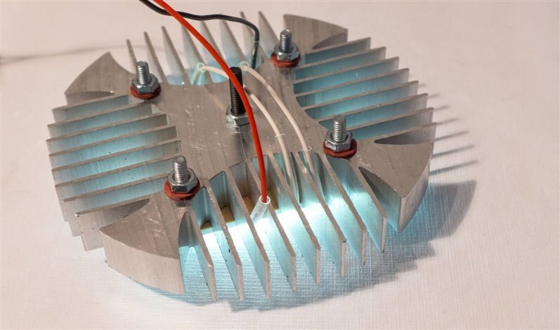

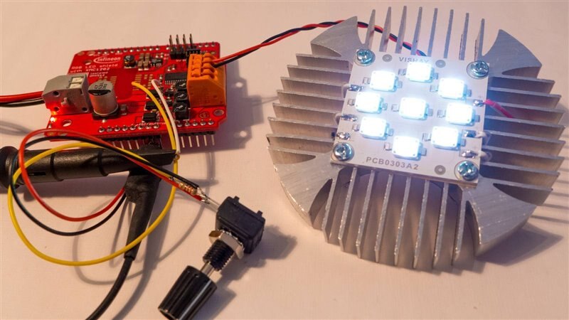

The Vishay LED module contains three sets of three LEDs in series, brought out to solder pads. I decided to chain all three sets together to form a single set of nine LEDs in series. Here is the LED module all wired up for testing:
The yellow wire is an input signal, which I wired up to a potentiometer (check out the comments in the getting started blog post which lists the pins available). The LED shield contains an ARM Cortex-M0 processor and it is possible to modify the demo code in order to read input signals from switches or potentiometers. The steps on how to program the board are in the getting started guide blog post too. The white wire that is connected to an oscilloscope probe is discussed further below.
Here is what the heatsink and LED module look like from the other side (the longer center bolt can be used to either suspend the lamp or to fit it to a holder):

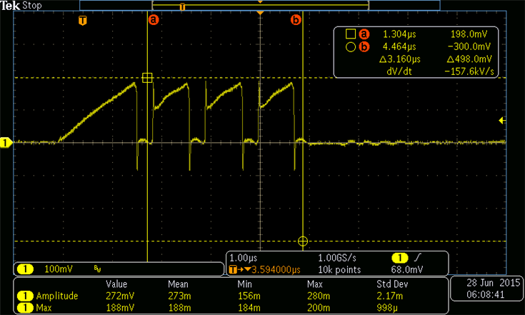

The white wire mentioned earlier is connected to the current sense resistor on the board; it was connected to an oscilloscope so that the configuration parameters of the LED shield could be optimised.
In brief there are two main parameters; one parameter sets the peak voltage level at which the microcontroller will switch off the buck converter and the other parameter is used to insert a delay between cycles for the buck converter. Again, it is possible to refer to the getting started guide for more information on these parameters and example oscilloscope traces.
Since there were nine LEDs in series, around 36V is needed to control them according to the LED module datasheet.  A 48V power supply was selected. With the supply connected up, the voltage across the current sense resistor was observed with an oscilloscope. The two configuration parameters were adjusted to ensure that the current through the LEDs did not exceed the datasheet specified maximum value and to reduce the ripple so that the average current through the LED was close to 700mA. The final result is shown in the trace below. It can be seen that when the buck converter MOSFET is switched on, current through the 0.2 ohm sense resistor (and the LEDs) rises. At a peak value (188mV in the trace below which corresponds to 0.94A of current flowing through the resistor) the MOSFET switches off and current will continue to flow due to the energy stored in the inductor (this is not visible on the trace since the current sense resistor is now not part of the current flow path until the MOSFET is switched on again. It can be seen from the trace that when the MOSFET is switched on, the current will again rise until the 188mV peak. The average current is very close to 0.7A (by observing the minimum and maximum voltages on the ramp in the oscilloscope trace), and the peak is within the safe limit of 1A the LED module is rated for. For those interested in using the same LED module, the parameters I used were: CURRENT_RED/GREEN/BLUE=0x80, OFFTIME_RED/GREEN/BLUE=0x09.
