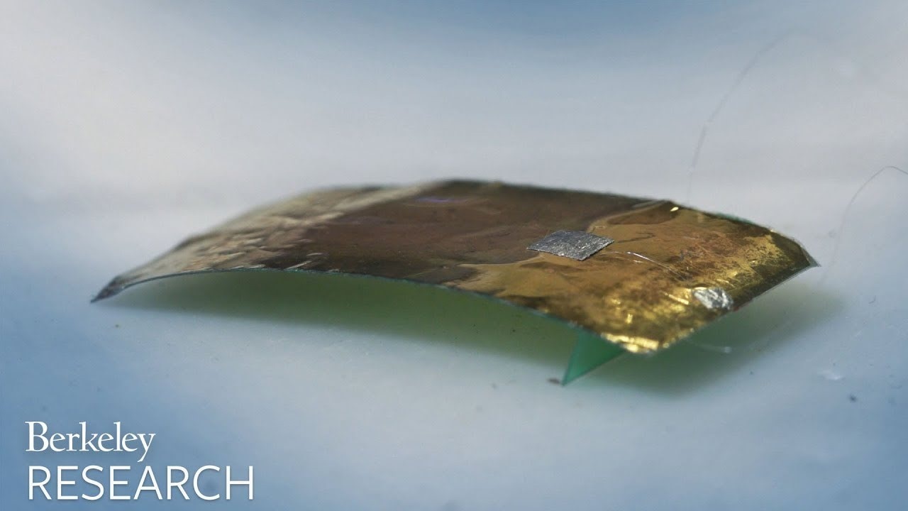

Cockroaches are one of the most polarizing insects on earth. On one hand, many people consider them to be disgusting, disease-carrying bugs that crawl in the shadows and feast on garbage, but others view them as nature's great survival experts that can even survive deadly nuclear radiation. However, a group of researchers at the University of California - Berkeley, have used cockroaches as their inspiration for a new type of micro-robot that could revolutionize the way we search for survivors after natural disasters and other tragic events. At first glance, the robot looks like a small scrap of paper lying on the floor, but upon closer inspection, one can see that the robot is much more than just thin paper, and actually features two very small “feet” that are attached to a larger flat body. Exiting one end of the robot is a pair of very thin wires that leads to a waveform generator.
(Image Courtesy: UC Berkeley)
The robots are made of a thin layer of polyvinylidene fluoride, a piezoelectric material that is then encapsulated in an elastic polymer material. A small plastic leg is affixed to the underside at the front. When an AC current is applied to the piezoelectric material, the whole robot recoils slightly and then flexes back to its original shape. When this is done at high frequency, the robot scurries forward in a very cockroach-like manner. This inchworm type motion is quite efficient, and is able to propel the little robot forward, up hills, and even through pipes and tunnels.
What makes these robots so special is their simple design that features no mechanical parts. This means they can be made very small and very thin, and thanks to their elastic polymer frame, they even recover well from essentially being crushed flat by a human foot. In fact, the small robot pictured above is able to withstand over 60-kilograms despite weighing less than 65-milligrams. That’s about one million times its own weight. They are even able to carry something small like a peanut that weighs 500-milligrams which is five times its own weight.
