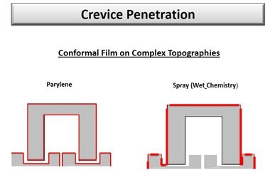

Uniformity and the ability to get at those "hard to reach places" is key to Parylene coating. The difference between the correct way and good enough. (via Diamond MT)

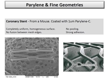

When it comes to protective coatings for devices on a nano-scale such as sensors, actuators and mechanical structures, the coating needs to be impermeable against contaminants at the submicron levels. This is where Diamond-MT’s Parylene conformal coating shines, as the material offers superior protective properties than that of its competitors. The material is applied by vapor deposition inside of a vacuum and therefore can penetrate crevices down to an astonishing 0.01mm. This results in a tighter-fitting conformal layer than those applied by other methods such as spraying or dipping, which can result in an uneven layer and thereby negate the protective properties. The material is hydrophobic, making it water and liquid repellant on a very small scale free of pinholes. Parylene also features a low dielectric constant (electric insulator) as well as low current leakage (electrostatic lines are not impeded), which makes it ideal for incredible small electronics such as MEMS. Temperature almost becomes a non-issue using Parylene, as the material is able to retain its protective properties without degradation for 10-years at 800C and has a temperature threshold of an astounding 2000C! The polymer applies clear and stays clear while providing protection against UV rays that can damage sensitive electronics and optics. It’s no wonder that Diamond-MT has been coating sensitive MEMS-based electronics for the last ten years, as their Parylene coating is far superior to the other conformal coatings currently on the market.
