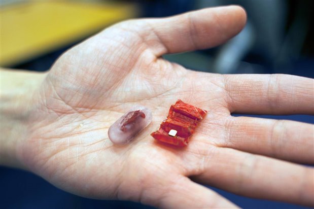

MIT’s Ingestible Origami Robot can be used to remove internal foreign objects and perhaps perform some surgery. (Image credit MIT)
The tiny origami robot is swallowed in pill form, travels through the body magnetically and unfolds itself, unveiling a tiny magnet within to attract any metallic body inside the stomach. It can also propel itself along the stomach wall using ‘slip-stick’ motion, meaning it uses its appendages to stick to the surface of the wall through friction when it moves. It slips free again when it unfolds or changes its weight distribution.
The robot itself was designed using two layers of structural material that sandwiches another material (in this case pig intestine) that shrinks when heated. The number and location of tiny slits on the external material determine how the material unfolds, thus unfolding in a pre-determined desired pattern. MIT’s Origami Robot was designed to trap and collect metallic ingested objects such as batteries, which apparently 3,500 people swallow every year in the US.
