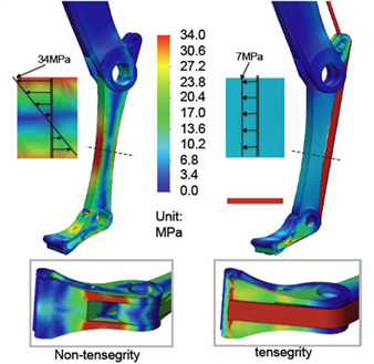

(Left) Leg concept and production part. (Right) Tensegrity analysis. (via MIT)
The Cheetah Bot’s composite frame is made out polyurethane filled with foam “bone marrow.” This structure is then covered with resin that makes the “bones” low-mass and high-strength. Kevlar tendons representing the Achilles tendon and the gastrocnemius muscles carry tension and replicate the tensegrity of the bones in the foot and leg of a real cheetah. This replica structure reduces the stress in the robot’s joints by 60%, which further improves the mechanism’s overall efficiency.
