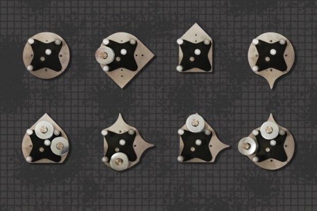

A key to compiling the novel Omnipush dataset was building modular objects (pictured) that enabled the robotic system to capture a vast diversity of pushing behavior. The central pieces contain markers on their centers and points so a motion-detection system can detect their position within a millimeter. (Image Credit: MIT)

The modular objects used in this study are what really sets it apart from previous datasets. Weighing just 100-grams each, the aluminum objects are able to be configured in a number of ways by adding on different shaped components, adding extra weights to their chassis, and even shifting their weight distribution. This allowed the team of researchers to develop 250 different combinations from just a few base modules. Each module featured a unique marker on its surface that allowed the vision system to focus on it.
