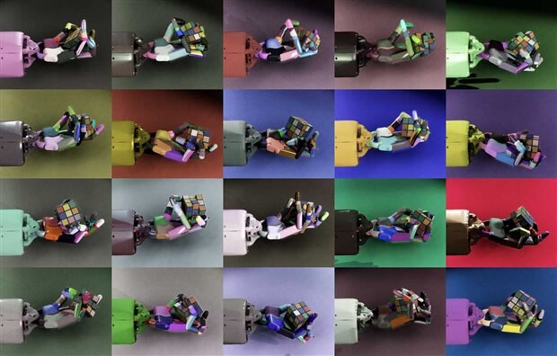

The researchers first trained the neural networks to solve the Rubik’s Cube in simulation using reinforcement learning and Kociemba’s algorithm for picking the solution steps. Utilizing domain randomization, they were able to transfer those networks directly to the robot, but that was not enough. Variables like friction, elasticity, and dynamics are very hard to measure and recreate in a simulation which forced the team to create a new method called Automatic Domain Randomization. This method allows the team to endlessly generate increasingly difficult puzzles to solve in the simulation.
Domain randomization exposes the neural network to many different variants of the same problem, in this case solving a Rubik’s Cube. (Image Credit: OpenAi)image
“ADR starts with a single, nonrandomized environment, wherein a neural network learns to solve Rubik’s Cube. As the neural network gets better at the task and reaches a performance threshold, the amount of domain randomization is increased automatically,” the team wrote. “This makes the task harder since the neural network must now learn to generalize to more randomized environments. The network keeps learning until it again exceeds the performance threshold when more randomization kicks in, and the process is repeated.”
Using ADR the team was able to train the neural networks in the simulation, then pass that training onto the real robotic hand. This works because ADR is able to expose the neural networks to an endless, ever-increasingly difficult variety of simulations. The dataset that is gathered helps the robot quickly identify and adjust to whatever pattern is currently displayed on the Rubik’s cube. The team took things a step farther, and physically interrupted the robotic hand while it was attempting to solve the puzzle. In one experiment, a blanked was tossed over the had as it manipulated the cube. Another experiment used a plush giraffe to try to push the cube out of the hand. The team also did things like strapping two fingers together to simulate tired fingers, and they even placed a rubber glove over the hand. The results were quite favorable too, with the ADR trained networks being able to instantly overcome and adapt to the perturbations.  The system is not perfect just yet though with the team admitting that the hand is capable of successfully solving the cube just one-fifth of the time if the cube is scrambled to the max.
