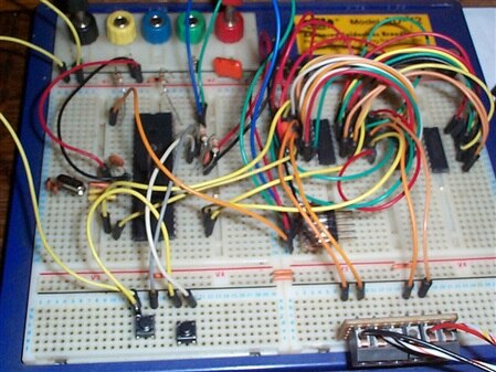

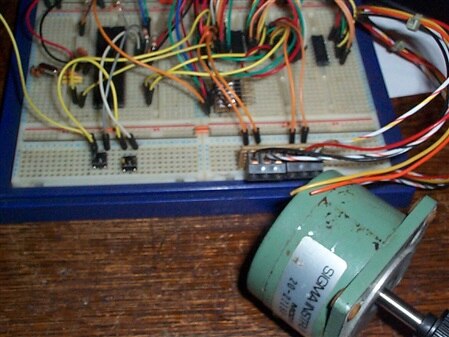

    Sure, I`ll include some pictures, although it May not be any clearer from them what`s what exactly as there`s a load of wires in the way:
    Breifly, on the far left is the PIC 16F877A that I`m using to prototype my code on, eventually this code will go onto a 16C57 chip, the 2 switches left front are Motor direction, there`s also Direction Inhibit resistors on the chip to keep pins 6,7 on portB low, if one goes High (a limit switch activates) then it stops movement in that direction..
    the 2 chips on the right are both H-Bridge drivers wired pin for pin to each other, front right is a simple breakout board because some steppers have wires too thick to fit into breadboard.
    the array of 6 pins in the middle of the board is so I plug my PICKIT2 programer into it.
    this is One of the steppers I`m using on it, ignore those 2 wires (Org, Yel) they`re not used in the Bipolar implementation.

    Putting these parts in parallel is a very bad idea for anything other than a quick hack. Because they contain built in thermal protection it is possible for one device to shut down when it gets hot, this will leave the other to do all the work, so if you are lucky it will shutdown very quickly. There is nothing to ensure that the load is shared equally. You could improve matters by putting resistors in series with the drivers (about 0.5R seems about right) but for a reliable soultion you should get drivers that can cope with the current.

    What bothers me is that it looks like the kind of thing that will work on breadboard but less well in real life on a pcb - the breadboard will introduce quite a bit of extra resistance in the ciruit which will improve the current sharing between the chips. Using power transistors in parallel is nothing new but any reputable design I have seen uses current sharing resistors. With current sharing resistors the 7544410s should be OK but quite abit of power must be wasted in the resistors. Lower value resistors can be used if the drivers are matched for voltage drop at working current.
    The bad thing (with these drivers) is that if the chips get hot then the built in protection will turn one of them off leaving the other to carry all the current - this might be OK but would need careful verification.

    I think what helps a little in this particular cct, is the fact that the 5v PSU is only rated at 1.5A, but more importantly that a Single driver chip will run these motors, just not very comfortably and Do get quite hot on their own, a situation that stop when paired up.
    I have put in a couple of .5R resistors on the Motor Drives + rail anyway as I agree that it`s always a good idea to have buffer that helps balance inequalities.
    I`v tried a variety of On-Fail scenarios with these chips and haven`t popped one yet, consisting mainly of pulling out one wire at a time and testing for heat, and then moving on to the next wire etc...
    it seems to be a remakably robust little curiosity!
    I think perhaps the next stage should be to put onto a board and test it from there, and add some Reverse biased diodes across the  Motor wires to protect against back emf spikes, yeah, I don`t even have any of those in yet!

    after some thought about your objections, and the way that wiring this board happened to turn out purely by accident, I think I have a solution!
    on this board it would save a LOT of extra wiring if I put One phase on one chip and the other phase on the other chaip, rather than have 2 phases on each chip.
    therefore Should there be any heat discrepancy between one phase and the other, being on the same die, the chip simply shuts down a Phase, and doesn`t have to be trying to Half work the other phase at the same time.
    so even if one chip entirely overheats or shuts down, it`ll not effect the other, but I still get the 2x Current! image
    I can`t think of any other way to get a better thermal intimacy and matching than this.
