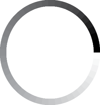

    e14 Contributor over 13 years ago in reply to DAB
    Hi DAB,
    I think I liked your idea about having a grayscale ring (I'm attaching a file I created based on how I interpreted your reply).  I do have a follow-up question: If I at some point put a night-vision camera on the turntable, would the grayscale ring approach still work?  If not, maybe taking the linear potentiometer approach would be the better route.  The biggest problem I'm seeing right now with the linear pot (as described by Peter and Raimondas) is that I'm still unclear how to attach it.  My current design has a vertical "drive" shaft coming through the center of the turntable and it's getting in the way of how I thought the linear pots would attach.  Maybe I should just order a couple different kinds and play around with it.
    Thanks.

    DAB over 13 years ago in reply to e14 Contributor
    If you set up a LED and light detector over the ring, it would work in any lighting condition as it is only focused on the ring.
    You determine position by measuring the amount of reflectance from the ring based upon the level of grey that the detector sees.
    You can use gears to turn a potentiometer or an encoder to measure movement.  It all depends upon how much you intend to move and how accurate you need to know the position.
    Attaching the encoding device depends on access and resolution.  Most application would use the encoder on the primary turning access with a reset when you go 360 degrees.  However, you can use a series of gears or other connections and derrive your position from the movement of the table.  Again, accuraccy and repeatability will drive you to the best solution.

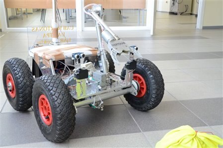

    Ramu over 13 years ago in reply to DAB
    Yes it depends on how acurat you want it to mesure. As for axample for this robot:
    For hand position we ussed 2 regular potensiometers. It is not even a liner potensiometer, but still does the trick.
