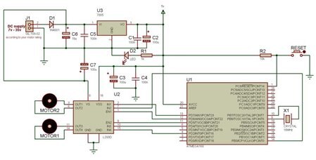

Hello, I am currently building my first robot using the L293D IC chip to drive my two DC motors and an ATmega328 as my micro controller chip. To integrate these two together correctly i have have been attempting to read a schematic i found online that did that very thing and have been fine so far until realized that the schematic was divided into different section. For example power supply would be one part and the IC chip itself would be a completly unconnected other section. I realize that the grounds and positive voltages connect through out the different parts but there are so many different parts and connections i have no idea which goes to which. It would be a huge help if someone could help me out with figuring this out, Thank you so much! (The schematic is in the link below just scroll down)

    johnbeetem over 13 years ago
    Follow the names: signals with the same name are connected to each other.  All the GND signals are connected to each other.  The barrel jack provides VSS which is the voltage for the motor (7-12V recommended).  It's regulated down to +5V by IC2, or you can jumper +5V to USB5V from JP7.  +5V is used by IC1 -- the ATMEGA MCU.  The L293D (IC3) has pins for  both +5V (for logic inputs) and VSS (for the motors).

  • sunnyiut
    sunnyiut over 13 years ago
    don't know whether its too late for a reply.
    Tony, u have attached a schematic, which was for a complete board with other options, but I think you are using standanlone microcontroller. In that case may be the enclosed Pic will help u. I have just redrawn the schematic for only L293d part with AtMega168, excluding other features. The supply voltage should be greater than 7v and will depend on your motor rating. if you want to use it with Atmega328 then the pin configuration will be different. will be glad if it helps you.
