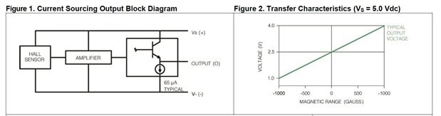

    With a 5.2 volt supply to the Hall Effect sensor the output is approximately 2.6 volts. When a magnetic field that is passing through the sensor this voltage either increases above the 2.6 volts or decreases below the 2.6 volts depending on field polarity. The amount of of the increase or decrease depends on the strength of the magnetic field. Here is a snippet of a graph from the Data Sheet that shows this relationship.
    Click on the image to enlarge it. This came from the Data Sheet listed above.

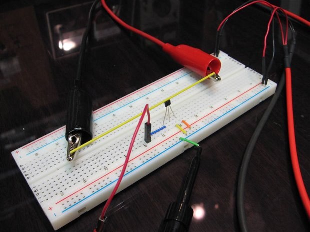

    Here is the setup that I bread boarded to test this Hall Effect sensor under your specifications.
    The Hall Effect sensor is the small black transistor like device. I am powering it with a 5.2 volt supply which is a tad higher than shown in the data sheet graph. This has no effect except to raise the output to 2.6 volts when there is no magnetic field. The Yellow horizontal wire is hooked up to a separate power supply and a load so that I can put 1 amp through it, just as your window heater wires would experience under normal powered conditions. I experimented a while to see where I could get the best sensor reading on the current in the wire. I found that I was not able to detect the current in the wire unless the yellow wire was sitting right on top of the sensor. The magnetic field from 1 amp is quite weak and there was no ability to sense it with this sensor if the wire wasn't directly on top of the sensor. Here are the readings that I got on my meter.

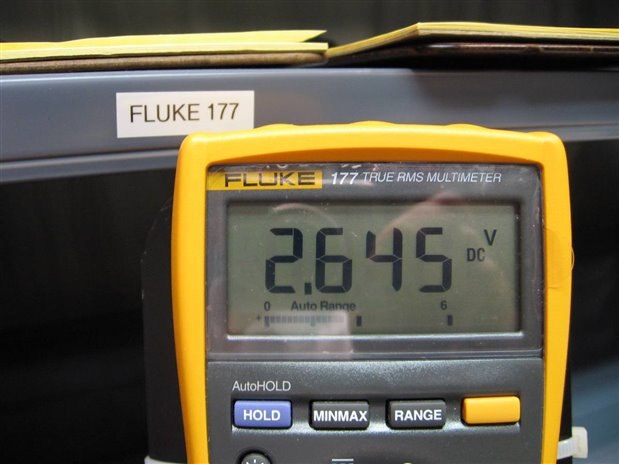

    This is the output of the sensor when there is no current in the wire.

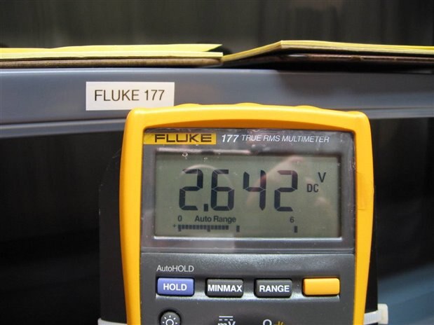

    This is the output from the SS49E Hall Effect sensor when the current in the wire is 1 Amp. This is only a change of 3 millivolts. I wish I had more experience with Hall Effect sensors so that I could recommend a specific sensor. One of the engineers on this site will probably have a good recommendation for you. This sensor, while it demonstrates proof of concept, would not be sensitive enough for your application. 3 mV is weak enough so that it would be difficult to discriminate it from noise in your test setting.

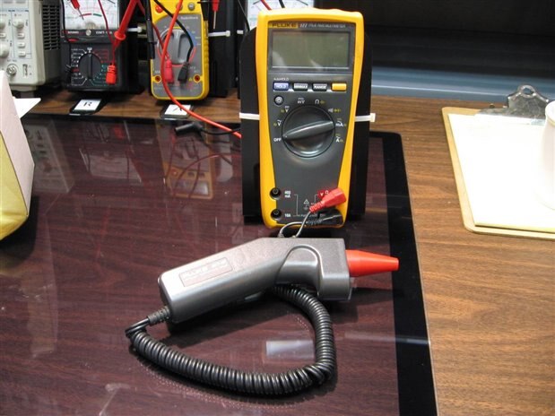

    I borrowed a Fluke 80T-IR Infrared Temperature probe from my sons shop to see how accurately I could read the temperatures of the individual wires in my rear window. The 80T-IR will plug into any handheld DMM. It outputs the temperature to the multimeter at 1 mV per degree. The scale is selectable C or F by a switch in the battery compartment. I was able to easily read the temperature of each of the wires in the window as they heated up. This temperature probe is 22 years old and they are still available on EBay for $60.00 and up. The more modern probes are probably more sensitive and accurate. A person could easily check each of the 12 wires in the window in the time it would take to position a test jig that would check all 12 simultaneously. Something to think about.
