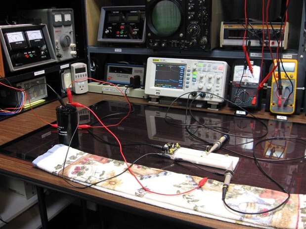

    I took your suggestion and set up the test using the same Hall Effect sensor but I charged a 1000 uF capacitor to 60 volts and discharged it into a 10 ohm load in series with a wire run across the sensor's sweet spot. I also had the scope set to capture the 60 volt pulse on channel one as well as the pulse from the sensor output on channel two. I read the output of the sensor through a 100 nF cap to eliminate the DC bias. Here is the setup on the bench.
    And
    Here is a photo of the waveform obtained. Sorry the trigger info got left in the shot. I will also include bitmaps from the scope of dots and vectors.
    As you can see our 60 volt pulse, generating approximately 6 amps peak, caused a delta output of about 18 mA from the sensor. This is a great improvement on the 4 mVolts we were seeing with a static current flowing. I intentionally limited the current in my test to 6 amps which I estimated was about 6 times the normal current in each of the window wires. Iansm could increase this but at some point the test may cause failures if any of the wires have a weak spot.
    If one were going to pursue this line of testing it seems that Robert Peter Oakes has us headed in the right direction.
    0 mcb1 over 11 years ago in reply to jw0752
    That is one VERY large 1000uF cap.!
    Well done it seems that this approach may be a solution.
    Out of interest do you think it could be detected in a coil, which may give a wider area and increased sensitivity.
    Robert Peter Oakes
    0 jw0752 over 11 years ago in reply to mcb1
    Hi Mark,
    I needed a cap with a capability to handle 60 volts and all I had was one rated at 400 VDC. image  The individual wires that Iansm wants to measure are all embedded in glass so getting any type of coil or inductive loop around them is out. Let me know if I misunderstood your suggestion.
