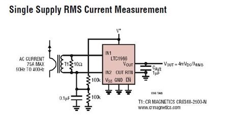

Hi,
a newbie question - but I am interested in a product to do a simple function - monitor current in an AC circuit, and if it goes above a certain value, throw a relay. I see a few DIN-rail units - undercurrent and overcurrent reverse current relays that keep a window and allow for a time delay and hysterisis functions to open and close a relay. But I'm interested in current flow direction in an AC circuit.
My question is - this AC circuit has current flow in potentially two directions, so the absolute value in Amps alone is not enough to make the decision to open/close the relay.  What product or combination of products could reliably detect current flow in one direction of an AC circuit, and throw the relay when the value exceeds a threshold. What might make it easy in my case is that the value is anything above 0 Amps in the outward direction.
Thanks, John

    Transformer coupling is a good approach. In other words, sense the current induced in the coils. You can buy devices like this, but if you want to build one on your own, try the LTC1966LTC1966 http://www.newark.com/linear-technology/ltc1966cms8-pbf/ic-rms-dc-converter-0-1-6khz-msop/dp/56M4388?Ntt=ltc1966
    Good luck.
    (via an app note)

    Thanks Cabe, this sounds good - is there a voltage out that corresponds to the direction of the current that is flowing in that 75A Max current that you're sensing? Thanks, John
