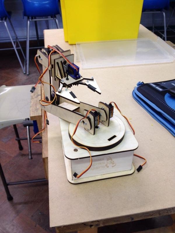

I am working on a Robotic Arm Project as part of my school studies. It has six points of rotation (Base, Shoulder, Elbow, Wrist, Wrist Rotate, Claw), all of these can be controlled by one micro controller board. It's a built up construction of Laser Cut Ply Parts that are held together with a combination of screws and wood glue, the separate sections are rotated by seven different servo's (the shoulder has two combined for added torque) which provide around 2.5kg per cm of torque (I think Im saying that right) at 5v and around 3kg at 6v. During testing the arm nearly threw itself off of the table, it can definitely handle it's own weight and needs added weight in the base. I am using brass tubing for the pivot points so that the separate sections can rotate smoothly around each other. Here is a picture:
